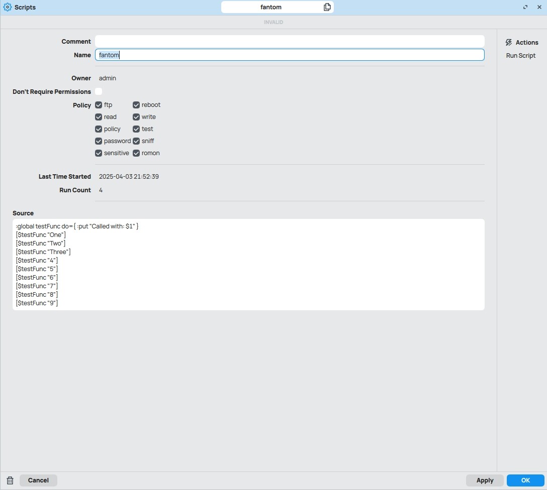

Run this code and see if there are gaps or not.
:global testFunc do={ :put "Called with: $1" }
[$testFunc "One"]
[$testFunc "Two"]
[$testFunc "Three"]

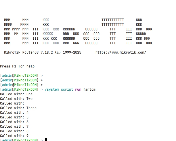

I get the same result no matter how many experiments I do.
/system script run fantom
Called with: One
Called with: Two
Called with:
Called with: Three
Called with: 4
Called with: 5
Called with: 6
Called with: 7
Called with: 8
Called with: 9
Tell me what I’m doing wrong?

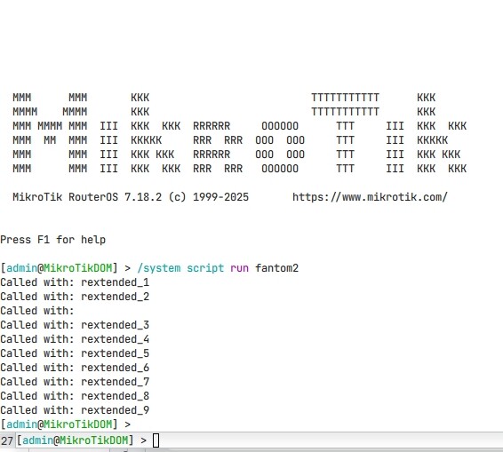

[rex@test] > {
{… :global testFunc do={ :put “Called with: $1” }
{… [$testFunc “One”]
{… [$testFunc “Two”]
{… [$testFunc “Three”]
Called with: One
Called with: Two
Called with:
Called with: Three
[rex@test] >
[rex@test] >
Error: double execution on 2nd run, like another 2nd run without parameters.

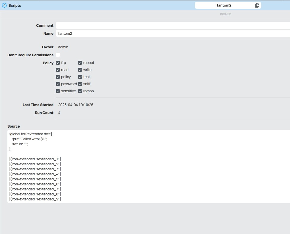

do {
script worng:
:global echo do={
    :return ""
[$echo "A"]
[$echo "B"]
[$echo "C"]
[$echo "D"]
[$echo "E"]
[$echo "F"]
script correct:
:global echo do={
    :return "Called with: $1"
:put [$echo "A"]
:put [$echo "B"]
:put [$echo "C"]
:put [$echo "D"]
:put [$echo "E"]
:put [$echo "F"]
[rex@test-v7] /system/script> export
2025-04-04 17:46:40 by RouterOS 7.16.2
software id = CHR
/system script
add dont-require-permissions=no name=script1 owner=admin policy=
ftp,reboot,read,write,policy,test,password,sniff,sensitive,romon source=":glo
bal echo do={\r
\n :put "Called with: $1"\r
\n :return ""\r
\n}\r
\n[$echo "A"]\r
\n[$echo "B"]\r
\n[$echo "C"]\r
\n[$echo "D"]\r
\n[$echo "E"]\r
\n[$echo "F"]\r
\n"
[rex@test-v7] /system/script> run script1
Called with: A
Called with: B
Called with:
Called with: C
Called with: D
Called with: E
Called with: F

This is a long-known bug of RouterOS, which I described, for example, here https://habr.com/ru/articles/646663/. It concerns not your function for Telegram, but all functions in general. If you call any function twice in a row (without assigning a result), it will be executed three times! You can check it yourself on any of your functions. A simple check in the function body fixes the problem: :if ([$len $0]!=0) do={ }.

If you’re so good at trying endlessly to disprove the obvious, you also know how to make your own scripts.
If you don’t like what I write, don’t read it.
Ok, I see, bad OP script in general… Regarring topic name, “bug” is resolvable by correctly calling functions.
Regarding useless return placeholder, I was just trying to point out that it doesn’t make affect on producing “bug” even if exists for some reason when function is called without square brackets, not related to your example.
