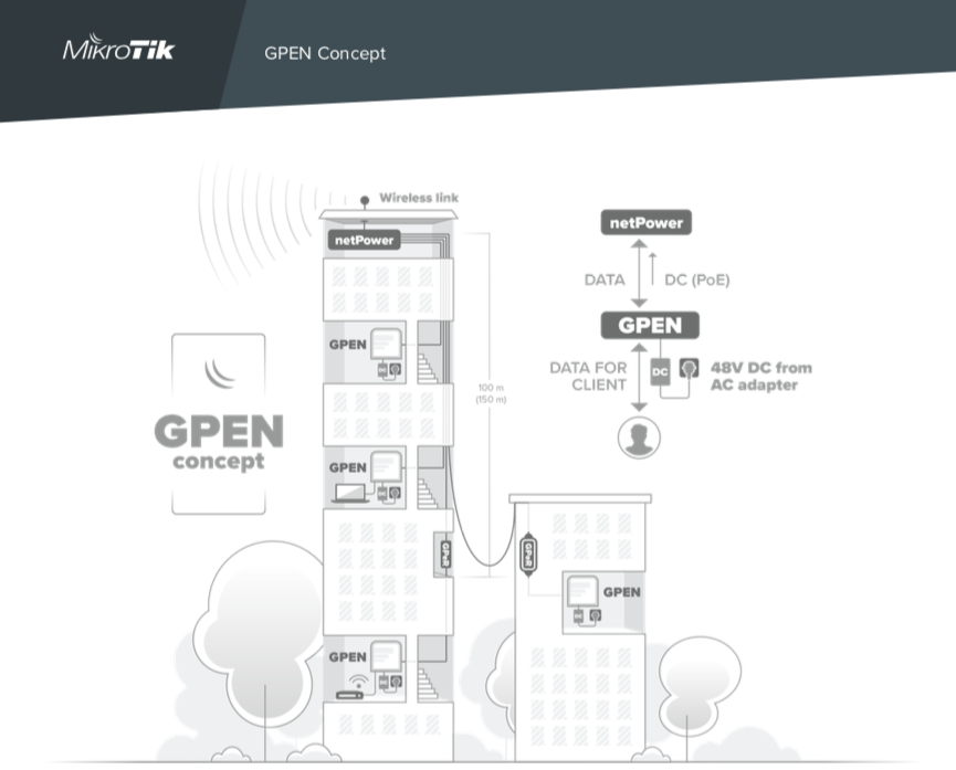

ccspdk, for this application I think a GPEN approach (Gigabit Passive Ethernet Network) can fit as a glove for building distribution to flats and keep costs down so that you can be competitive.
See newsletter and the GPEN concept)
