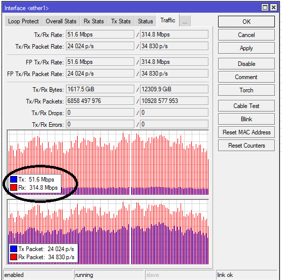

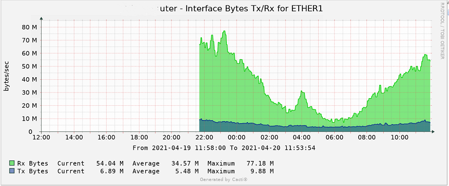

When I started to monitor my WAN interface ether1, after few minutes the graph appear with wrong information. Instead getting the bandwidth in Megabits , I am getting the values in mega bytes.
I checked the data sources in Cacti and there is no option for Megabits, only Mikrotik - Interface Bytes Tx/Rx for ETHER1 data source is available. So the question is how I can get the real data from CCR mikrotik to be graphed in Cacti. The bandwidth of ether1. TX/RX in Megabits.
This is the router traffic
And the graph from the cacti

While the Mikrotik template comes with an interface graph - you can use the cacti inbuilt NET-SNMP templates for interface counters too which do include Megabits per second (in 64bit as well). All my interfaces are using the default cacti SNMP graphs - and I use the Mikrotik template to get stats for non-standard items such as health items and Queue stats (as they do not appear via SNMP as an interface)
I’m not sure why the Mikrotik template doesn’t include one by default - but if you are set on using the mikrotik data collection method / template - you could also copy the interface template and modify it to multiply the value by 8 (and change the labels as well) so you now have megabits.
