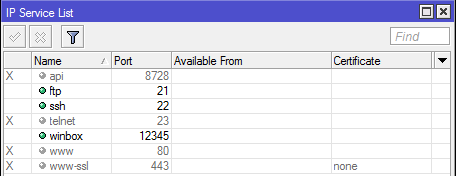

It is normally 8291 but it can be changed in /ip service
I don’t need to change anywhere else?
I have change in IP–>Service
but now I can’t go win into the router
“connection refuse”
You have to add a colon and port number after the ip you are connecting to.
Example: 192.168.88.1:12345

did it - and it’s working
