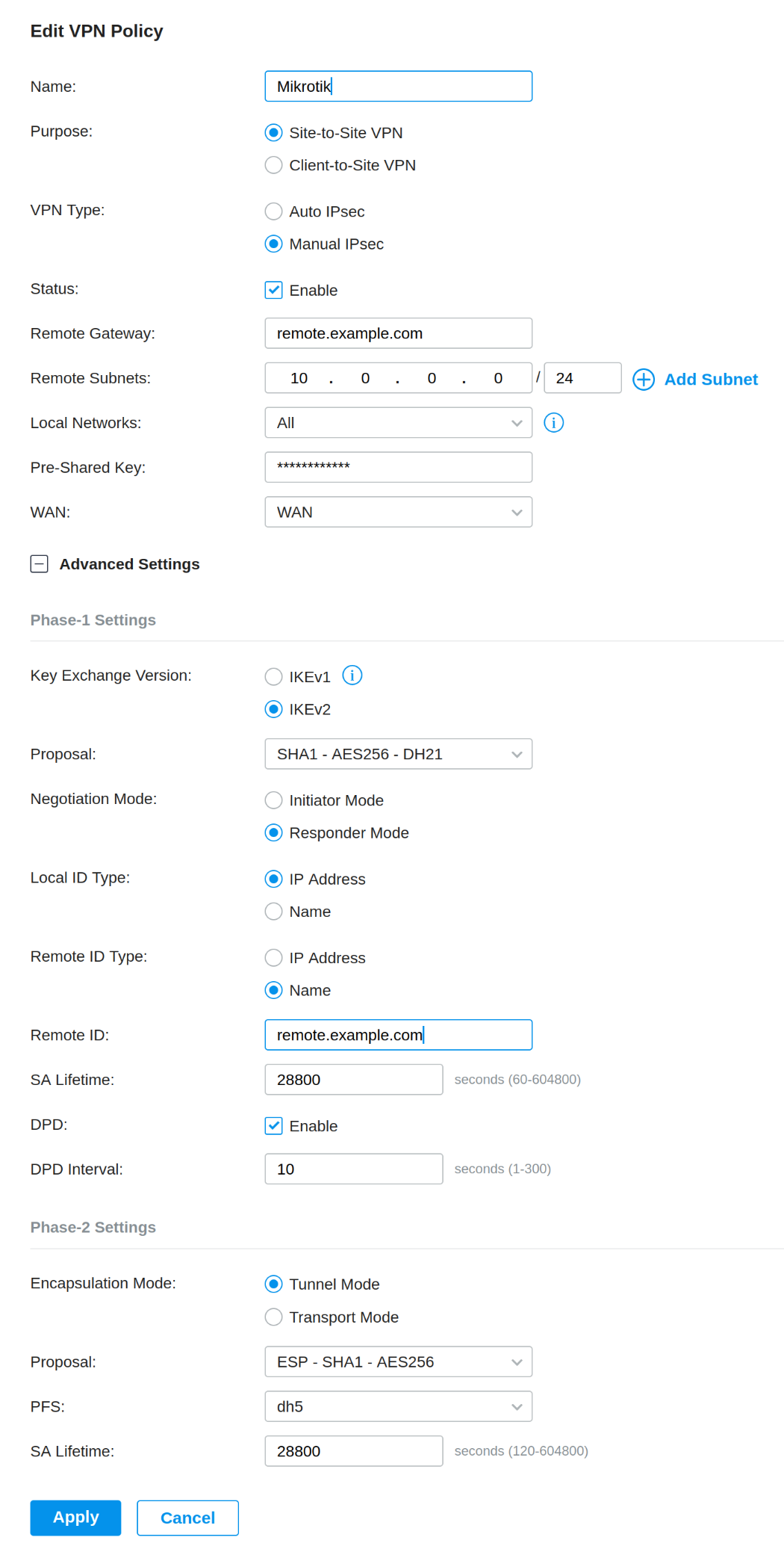

Here is my configuration of TL-LINK TL-R605

Also as you can see for tplink configuration i convert lifetime in seconds
08:00:00 is 28800 seconds
1d is 86400 seconds
And VPN dont WORK. Any advice??

Omada Settings:
