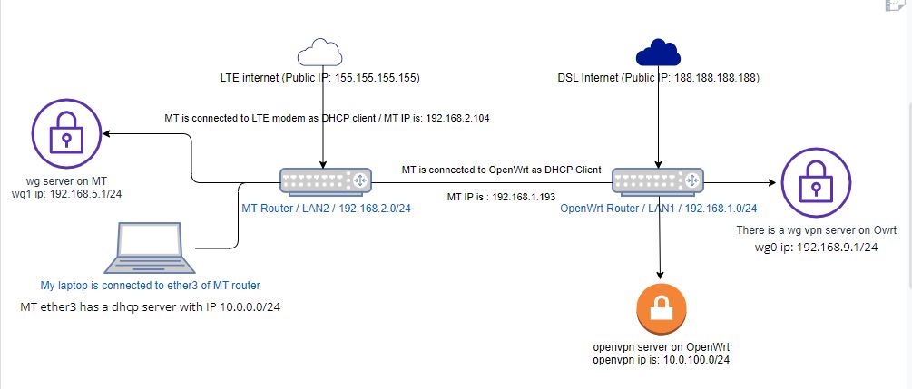

Here is my network diagram:
Internet via DSL Modem
OpenWrt router
| 192.168.1.0/24
| -- LAN1 devices
Mikrotik router with wireguard server --> LTE Modem
| 192.168.2.0/24
LAN2 Devices
So LAN1 gets internet from DSL and LAN2 gets internet from LTE.
The problem is that I cannot even access MT router web admin page or LTE modem web admin page using wireguard server let alone OpenWrt or LAN1 devices.

I did my best. I hope this diagram can help. let me know if you have any other question.
Thanks in advance
Okay its clearer now.
You have ISP1 - private IP via upstream router
You have ISP2 - a private IP IP from LTE modem.
What you are doing is port forwarding the Wireguard listening port from the openWRT router to 192.168.1.193 the mikrotik.
The WG server is on the MT.
The MT local LAN is 10.0.0.0/24
The MT wg server address is 192.168.5.1/24
you wish to be able to access MT from a Road Warrior device ( laptop, smartphone ) to config the MT or to reach devices on ether3 or reach the LTE webpage.
Do you even even get a good handshake? The input chain rule on MT for listening port counter goes up by one??
ISP1 (DSL modem) is in bridge mode. So OpenWrt connects directly to internet.
Yes that’s correct.
I have 2 wg servers. One is on MT and one is on Openwrt. With public ips from ISP2 and ISP1, respectively.
On MT, I forwarded wg listetning port from LTE router to MT.
There is no forwarding port on OpenWrt because it is connected to internet directly (DSL modem is on bridge mode)
Yes. Plus:
OpenWrt local LAN is 192.168.1.0/24
The OpenWrt wg server address is 192.168.9.1/24
I wish to be able to access MT and OpenWrt from the wg server on MT to config the MT or OpenWrt or to reach any device on OpenWrt or MT and also reach the LTE webpage.
