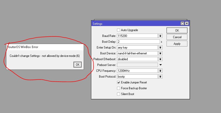

I have RB5009UPr+S+. For testing purposes, I’ve switched CPU Frequency in RouterBOARD settings from Auto to 1400MHz. I want to revert it, but I cannot do that - getting “not allowed by device mode: ()”:
I’m running 7.17.1 and the device is in Advanced Mode:

Any solution yet, or any workaround? If not allowed by device mode (6), in what mode i can change the CPU speed?
Now it’s hot summer day, lower the CPU speed to release unused power can lower the overall temperature, why lock it up?

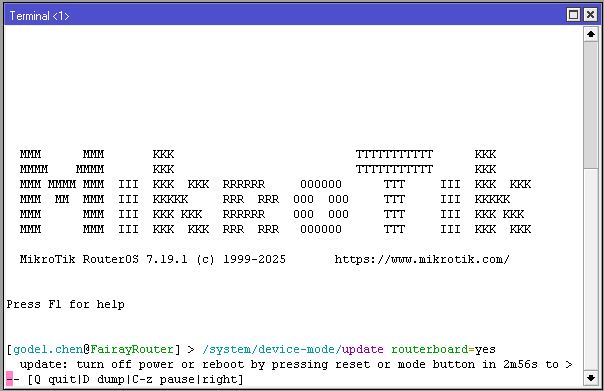

Are you asking how to set device mode to allow the CPU speed change or are you asking how to workaround the device mode?
If the first:
https://help.mikrotik.com/docs/spaces/ROS/pages/93749258/Device-mode
/system/device-mode/update routerboard=yes
A reboot might be needed.
Anything working to lower my CPU speed so to lower the CPU temperature too, sadly the command not working…
I chose to turn off/on power. What is mode button? I don’t want to risk and press reset…
OK, after second time rebooting, finally i can dial down my CPU speed, thanks.

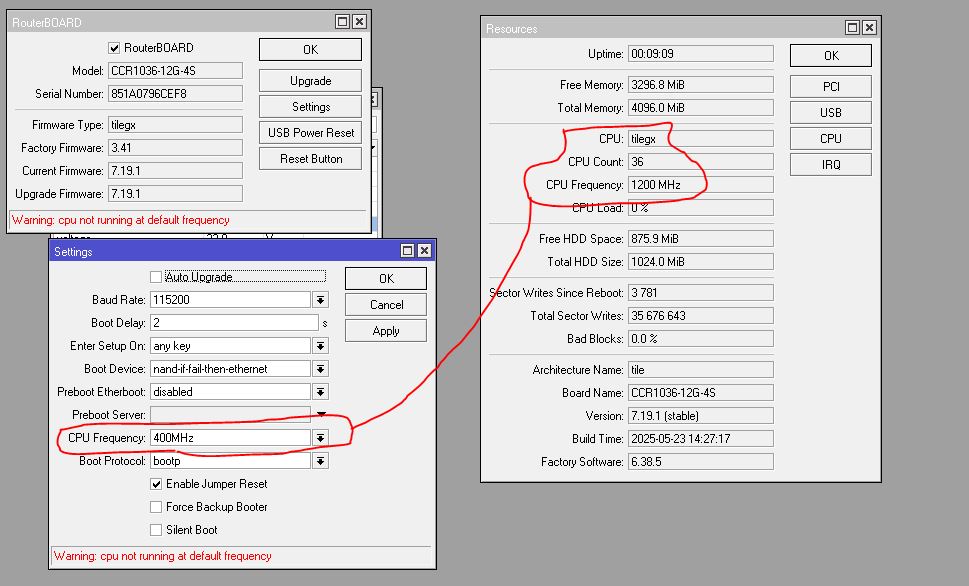

New problem. After dial down the CPU speed to 400Mhz, the resources still show the CPU in 1200 Mhz…
Hmmm. :confused:
Check also in terminal, should be:
https://wiki.mikrotik.com/Manual:System/Resource
/system resource print
And try rebooting again, it might be an artifact of Winbox UI.
