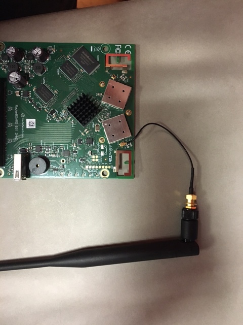

  • I have a Mikrotik 951 Routerboard. I am trying to connect an external antenna but I am not being able to enable it from within the Winbox. I went into Wireless interfaces and then clicked wlan1, but when I go into the HT tab there is no space to change the type to antenna-b.

I already connected the antenna to one of the MMCX connectors inside the box. I just need to enable it from within the Winbox.
I don’t think those MMCX connectors are there for nothing.
I am attaching a picture of the antenna connected.
People ask similar questions regarding different boards all the time. Mikrotik representatives always answer that those connectors are not for antennas, they are just some kind of factory test points. See, for example, here, here and here (and there’s more).
