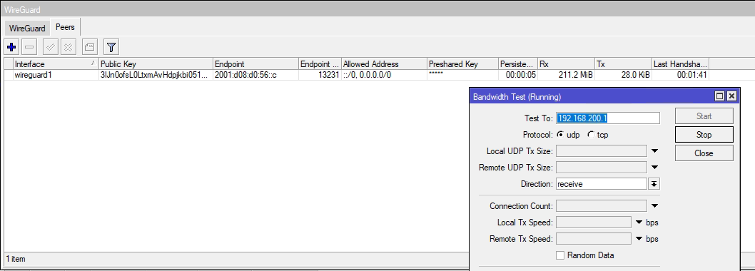

I have RB5009 and RB3011, I have successfully create a connection between router using Wireguard over IPv6

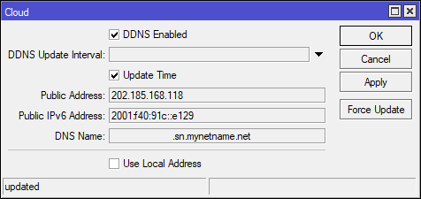

Check if your IPv4 is not a private class and is NATted from ISP, and on that case, you can not do nothing, except ask your ISP.
Both site having Public IPv4
Site: A, RB5009
ISP: Maxis
GPON Fiber, 500/100Mbps
121.121.202.184
Site: B, RB3011
ISP: TIME
GPON Fiber, 500/500Mbps
202.185.168.118

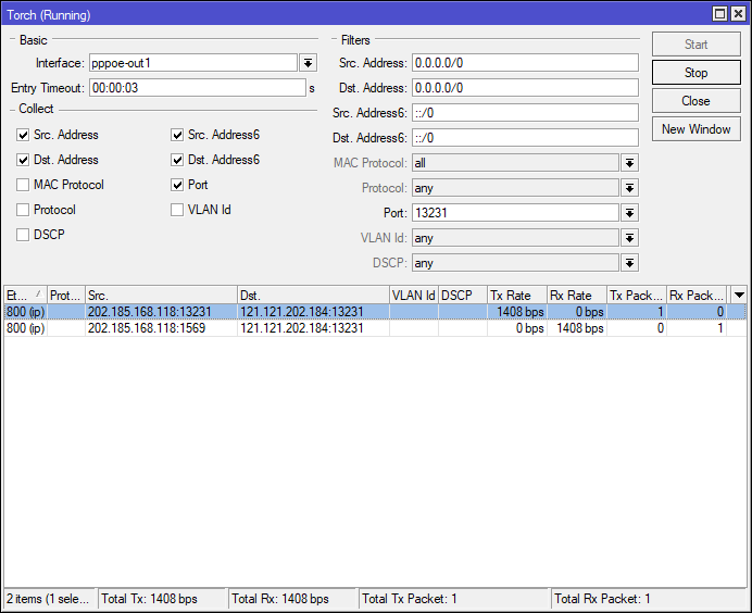

Torch:

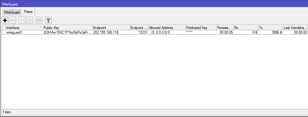

Site A to Site B, No Handshake:
… if I use IPv6 can connect, when I change IPv4 endpoint - never connect

both are connected… Mikrotik A WG cannot connect IPv4 endpoint to Mikrotik B WG or vice-versa (A>B, B>A)
Torch showing both is trying to connect, same issue with different port…
