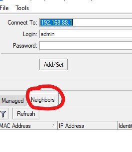

With WinBox, what is under “Neighbors” tab ? If there is a line, Click on the MAC address there, and connect via MAC address.

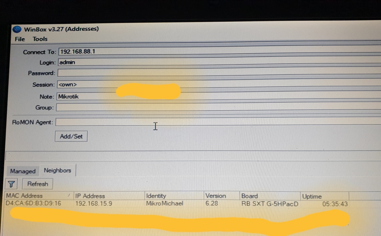

Now I found someone on 192.168.15.9
If I will open this in google chrome I cannot find it

192.168.15.9 tells me that you are connected on another network than the SXTsq 5 ac network. Plug the cable of your laptop in the PoE injector of the SXTsq !
And use “Neighbors” tab, not the Managed tab, to be able to connect even when the IP settings are wrong.

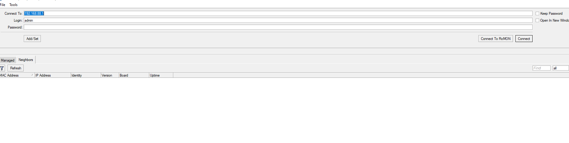

Okay- with cable of the laptop it cannot find neigbors ;o(
With cable in I see the following

Okay- I think I must do a reset
Connect by clicking on the MAC address, or hardware reset the device (preferred) as mentioned in the documents in the previous post.
Brand New??? With version 6.28 as factory default ??? Software 6.28 release note “What’s new in 6.28 (2015-Apr-15 15:18)”:
You might need to learn the “netinstall” procedure if you cannot upgrade, to give it a normal version. LT version 6.46.8 will certainly work (avoid Stable, unless you urgently need something of the new features)
Consider returning this device. It has been tampered with. (Or check under System-> Resources → Total Sector Writes, for no more than a few 100.000 writes, as the flash has a limited lifetime.)

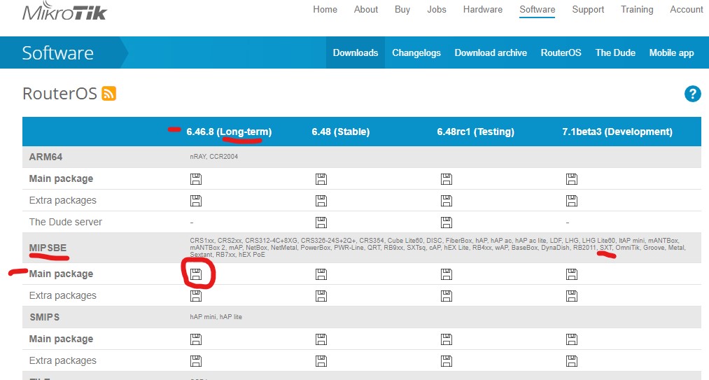

If I log in to the mikrotik website to search the 6.46.8 Version manually I found sooooo much files and dont know whats the file I needed

Download MIPSBE image. Drag it in “Files” window on the SXT and reboot.

So for your upgrade check the model and the Achitecture name (in /system resources), to be sure it is ‘mipsbe’ (the *.npk file is specific for the architecture)
