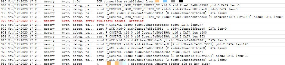

cannot establish ovpn connection
there is a “disconnected ” error when I try to connect ovpn server with android client.

I just was struggling around with the same issue, reading in this forum and didn’t found any solution.
After reading the log of the OpenVPN-Android Client more carefully, I found a solution, that I tested working on newest RouterOS (7.6) and latest Android OpenVPN Client (0.7.43) and I want to share it with others that are looking for the same.
In RouterOS in the OVPN-Server settings activate “sha1” in the “Auth” section and encryption “aes 256” in the “Cypher” section.
Like Sob suggested already, OpenVPN-Client is suppressing weak or bad/old cypher in the background. Resulting in client and server will not find a common encryption to use.
So you have to explicitly name it in OpenVPN-Client configuration:
Under basic tap you can leave compat mode to “Modern Defaults”
Under authentification/encryption tab name “AES-256-CBC” at Encryption ciphers and “SHA-1” at Packet authentification.
Now suppress fallback to other cipher:
In the advanced tab click “Enable Custom Options”
Add the Custom Options add “data-ciphers-fallback AES-256-CBC” and click ok.
With this settings you should now by able to connect the android client with RouterOS OVPN-Server.
