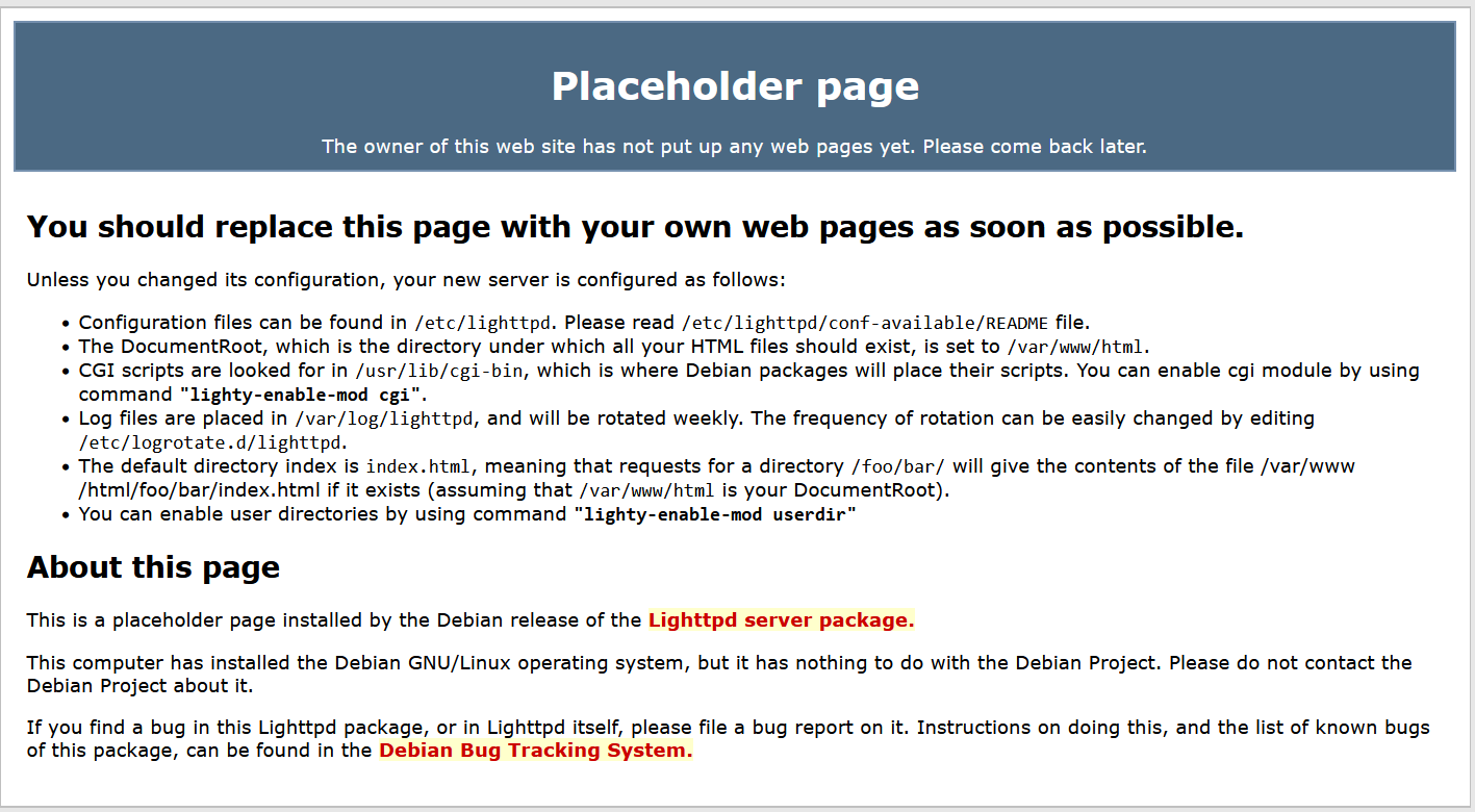

Cannot get to the config page of pihole on mikrotik
Hi
I have followed all steps in the following link [https://help.mikrotik.com/docs/display/ROS/Container] to setup the pihole on mikrotik.
It is running but I cannot get to the config page. Instead, I am getting the place holder page
What am I doing wrong? The container is running with no issue.

This is in the PiHole documentation. Please read it. You need to add /admin/ to the end of the URL
https://discourse.pi-hole.net/t/placeholder-page-docker/60498/2
