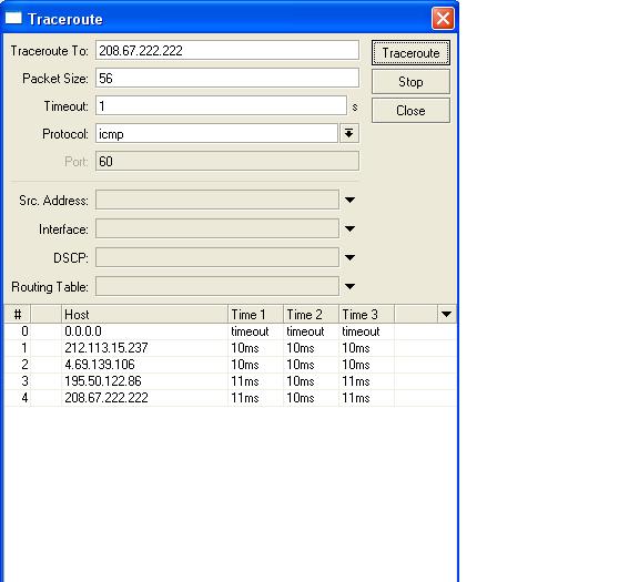

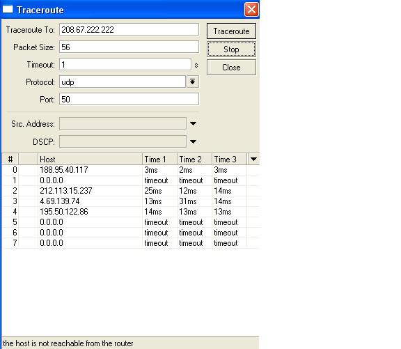

I have got a RB 1000, if i trace route for the open DNS which is 208.67.222.222 using ICMP protocol it works out fine. But if i change the protocol to UDP it can not find the route to open DNS. Also when using ICMP i get a time out in between the route. Can anyone please help me. I am using VOIP phones which use UDP SIP connections and right now they can not make calls because they cant get to DNS.

I have attached now both traceroute results. The time outs that i am getting are all at the ips that does not belong to my network. And you could see when doing a udp trace route it is showing me that the host is un reachable.
well, seems like it means that the host is not answering UDP packets =) and does not send ICMP rejects

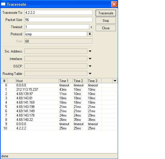

If what you are telling is right , when i use icmp and ping 4.2.2.2 from rb1000 it reaches there but breaks multiple times in between the route. How could you define that?
You mean a traceroute to 4.2.2.2 times out on transient hops but reaches the target? The hops the traceroute traverses don’t respond to ICMP traceroutes.
When you traceroute to a target, the client first sends out an ICMP traceroute packet with a TTL of 1. The first router in the way receives it, decreases the TTL to 0 and reponds. The client then sends out another ICMP traceroute packet with a TTL of 2. The first router in the way receives it, decreases the TTL to 1 and forwards the packet to the next router. That next router decreases the TTL to 0 and responds. Your client does that until the target router responds, each time increasing the TTL by 1.
If a router in the way doesn’t respond to the traceroute packet, the traceroute on that hop will time out. Your client will still send another packet with a higher TTL to investigate the next hop.
But I’m not sure I understood the question right.
I have attached another traceroute. You could better understand my question now.
Then I did understand the question right, and my answer applies.
