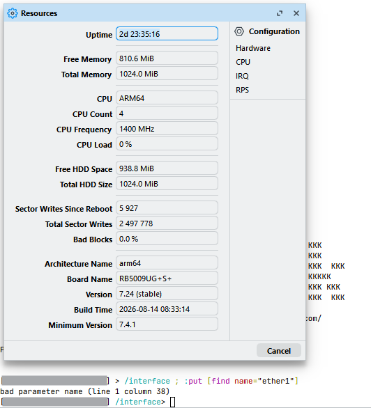

It's the same under WinBox 4, here's my RB5009:

No winbox, internally quickchr exec uses REST API POST /rest/execute to run them, so there is an implicit { } block
And appears to be the container package, in some quick tests.

(and if container is disabled (and apply-changes/reboot), the [find name=ether1] works.)
Here on arm device I have routeros,container,netinstall and do not have the issue.
My hAP ac² also has container and it's not affected.
