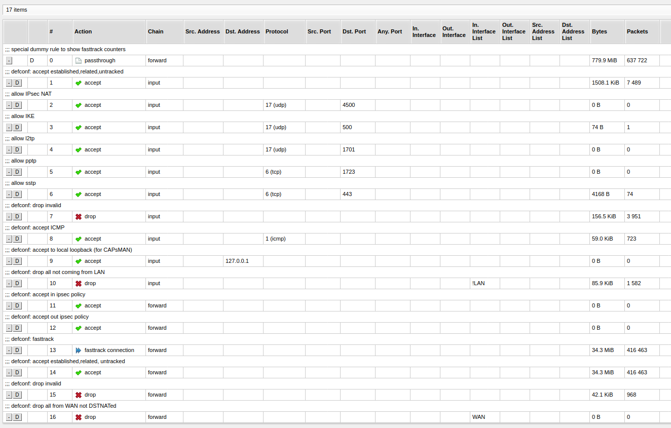

  1. I have attached a screenshot of the hEX-S’ firewall (it’s very basic to start). This would almost certainly give a more complete picture of my problem. Looking at the “chain” column, I don’t see any entry with dstnat, so this is likely the problem.
  2. Per my original post, I need to connect to a number of remote services, not just SSH. Is there a reasonably secure way to create a “catch-all” rule that would allow SSH, HTTP(S), VNC and other traffic through without specifying each port? This may be important as (for example) I have different SSH ports open on other routers in the case where multiple machines are “exposed” to SSH connections.
  3. Any idea (from the screenshot, maybe) why RDP and basic HTTP (with no specified port) is working?
Thanks so much for any further possible help. RouterOS seems really powerful, but as many others have pointed out, the initial learning curve is quite steep.
