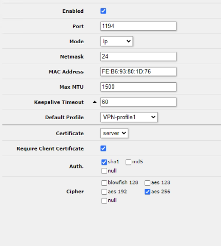

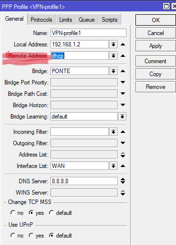

Hi everyone, I have the following problem.. I have enabled the VPN server on my mikrotik router to be able to connect to my home devices remotely.
My network is made up of two pools of IP addresses for other reasons; However, when I connect remotely
I can only connect to devices in a pool of addresses; which consists of the pool that I set in the OpenVPN PPP profile (as shown in the photo).
How can I see the two address pools by connecting remotely without changing my network? Thanks

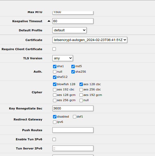

In OpenVPN its something called push route.
I think i have seen some changelog saying it’s now supporting push route.
So if you going into “OVPN Server” you have “Push Routes” there you have to add the another network.
So it’s added into the client routing table.
I didn’t find how to configure “push routes” in the OVPN server; Nothing is mentioned in mikrotik’s PPP profile.
In webfig you can find the settings here:
Menu: PPP
Key: OVPN Server

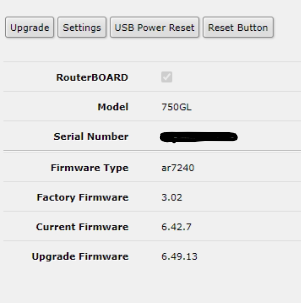

i don’t see this setting.. i also update the firmware but still nothing
You can see that on the latest ver 7.14
And if you login to MT demo router you can see that as well.
