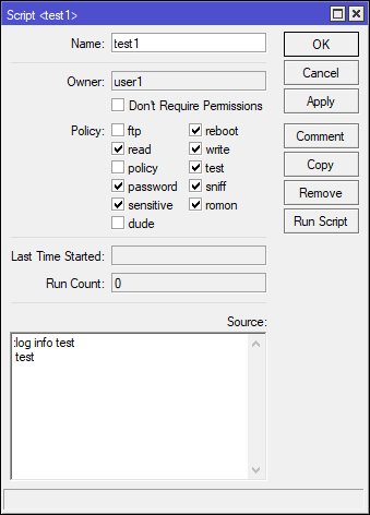

Have you tried an actual newline in your script?
E.g.
$API->write("/system/script/add
=name=test1
=source=:log info test
 test
Seems to work fine:

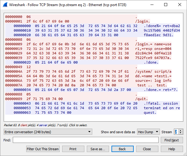

ASCII:
Hex:
Notice the 0d0a in line 0000007A which represents the actual newline.
Result:
