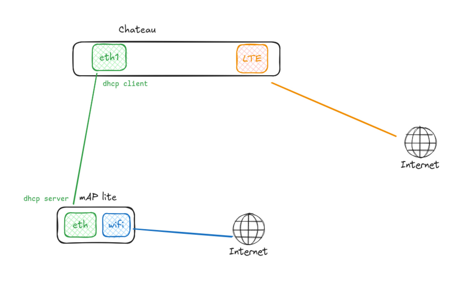

I’m trying to set up a recursive backup on my Chateu. I can’t figure it out.
The primary internet is provided via mAP Lite which is connected to eth1 (which gets the internet from my phone). Secondary is from the Chateau’s LTE modem. The idea is that when I turn on hotspot on my phone the Chateu should use net from mAP lite, otherwise from LTE modem.
Which requires recursive routing due to extra hop on the mAP lite. Without it I need to disconnect / turn off mAP lite to make Chateu switch to LTE.
