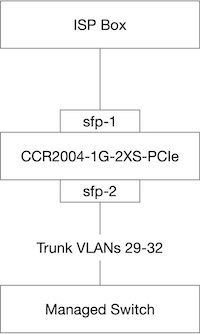

OK - I have what should be a very simple setup for using VLANs but for some reason it’s not working.
The managed switch is setup with the SFP+ port using VLAN tagging for the 4 noted VLANs, and individual ports are setup as access ports for the different VLANs. What’s interesting is that I can see that this communication is working properly when vlan-filtering is disabled and I’m plugged into an access port, Winbox shows the IP address of the interface for just that VLAN. It also shows an interface with an IP address of 0.0.0.0 which is puzzling. In this state I can use the Winbox via MAC address to contact the router, but I can’t get an IP from the DHCP server, and I can’t contact the IP address even when I assign a fixed IP to the workstation in that subnet. As soon as I activate vlan-filtering the router becomes completely unreachable over this interface.

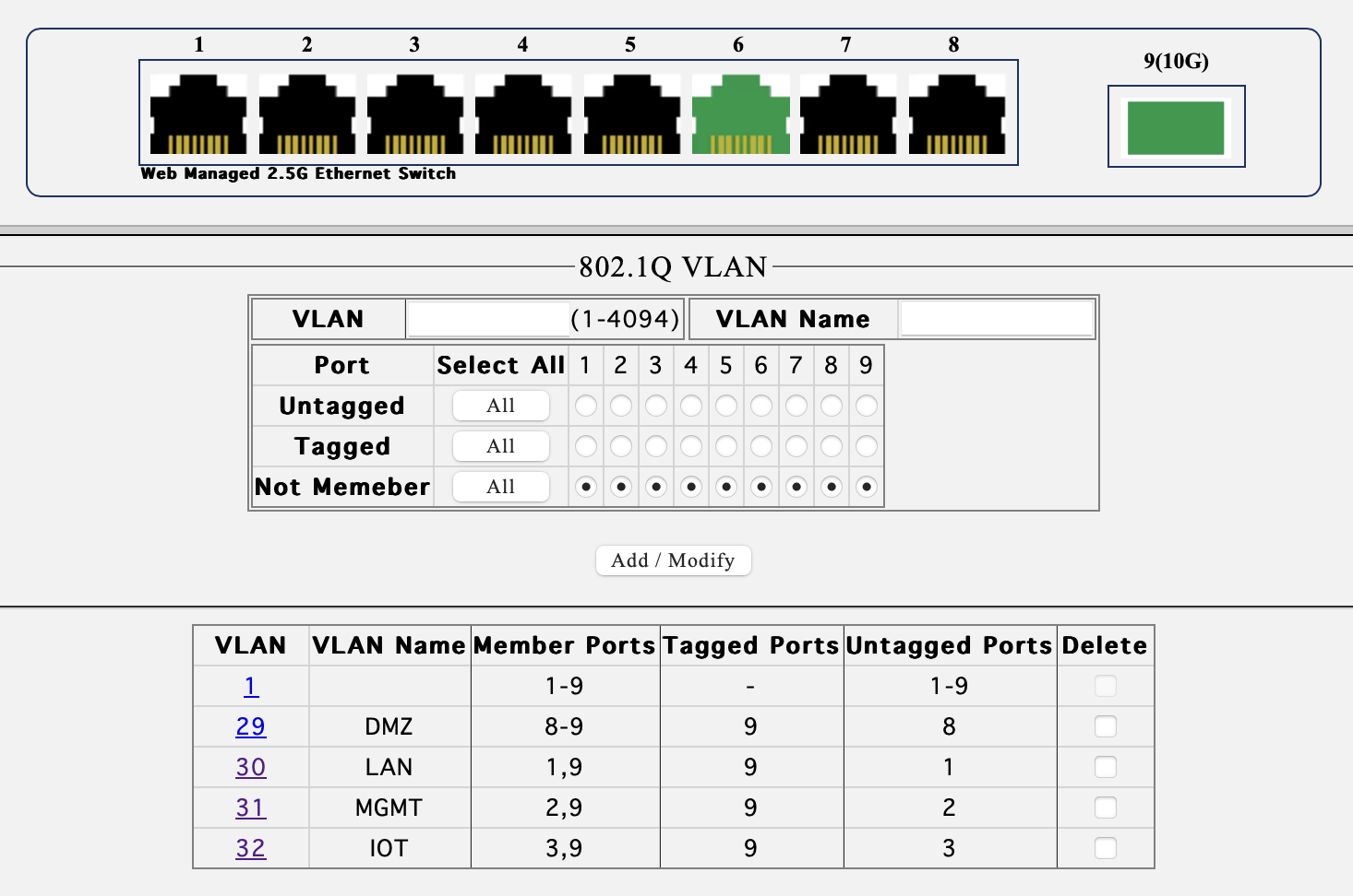

The switch is a really basic Mokerlink model setup with the VLANs tagged on the SFP interface and some access ports set up for testing.
It’s when I set vlan-filtering=yes that I lose all contact over the SFP+ interface
The settings on your Molkerlink is currently wrong. A port cannot have multiple VLANs untagged at the same time. Edit the entry for VLAN 1 and remove ports 1, 2, 3, 8, 9 (set to Not Member).
Done - but removing VLAN 1 from all ports doesn’t change the situation as far as communicating with the router.
Interesting. Are you currently connected to port #2 of the Mokelink? According to the screenshot, you are on port 6. Port 6 has no connectivity to the CCR2004.
That was just a screenshot I had on hand. When I’m connected to port#2 and I open Winbox, I see a good connection L2 Ethernet and I can see that the MGMT interface is properly associated with it’s IP but that information is all just broadcast over ethernet frames. There’s no L3 connectivity in that state or when I set vlan-filtering=yes.
