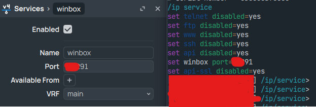

What are your settings there? Please share.
I don't use WinBox, is there a way to show this from web interface?
The config posted above is complete.
So it's time to start as it is the proper tool to manage MT's devices. MAC access is a lifebuoy.
If you have problems with WWW access why not to try it?
My primary computers are Mac and Linux, I'll take a look at it on my PC though. Thanks!
There are available native versions for Mac & Linux: https://mikrotik.com/download
Just in case:
