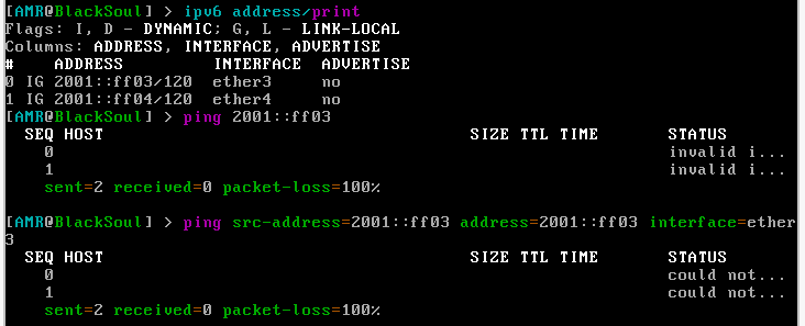

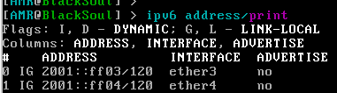

I set some IPv6 addresses on some interfaces:
and the problem is I can’t ping any of it’s interfaces (it’s ok via IPv4) nor I can ping a directly connected client!
It’s so frusrating!
Any help?

the funny thing is I can’t ping my ether4 IPv6 address from my ether4 IPv6 address!!
This is the simplest way I can explain my problem!
for example if you have an interface say ens35 with an IPv4 assigned 10.0.0.1, then you are certainly able to successfully ping it!
like with:
ping -I ens35 10.0.0.1
but the same process can’t be done with my Ipv6 assigned interface

These two IPv6 addresses are from the same /64 prefix. If one writes out the addresses in full (replacing that double colon with necessary number of zeroes), they are:
2001:0000:0000:0000:0000:0000:0000:0000
2001:0000:0000:0000:0000:0000:0000:0001
(parts highlited with green colour are prefixes).
So if you want to use non-clashing IPv6 addresses (and you do want that), you have to assign addresses from different prefixes, e.g.
2001:0000:0000:0001:0000:0000:0000:0000
or, written with double colon notation:
2001:0:0:0::/64 (or 2001::/64)
2001:0:0:1::/64 (or 2001::1:0:0:0:0 … one can not use double colon in same address more than once, this would make it non-deterministic as double colon serves as variable length zeros and it can be used only once)

IPv6 is disabled. I suspect that’s why addresses you self-assigned are marked as Invalid.

Thanks mr.mkx while I hadn’t notice these and these are indeed legit notable information, it doesn’t explain why one can’t ping the interface’s IPv6 address from within
until mr.Kentzo correctly mentioned that the
set disable-ipv6=yes
was actually the main cause of the problem
Thank you for your time.
/ipv6 settings set disable-ipv6=yes max-neighbor-entries=8192
This was the problem which kept me hanged for several days!!!
Thanks a lot
