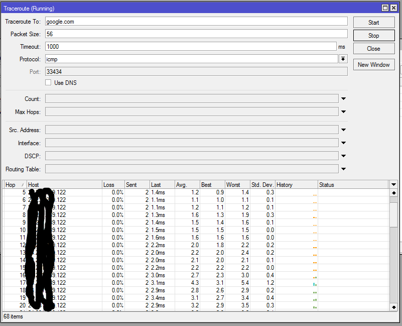

I’m just trying to narrow down what the problem might be with one of my clients. They can’t reach google for some reason, but everything else works fine. If I try to ping google.com from the router, it resolves but is being redirected back to itself? This might be something simple, but I haven’t seen this before.
Could this be an ISP issue?
Here are some screenshots:

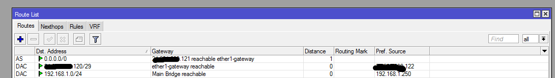

Please poste your routing table, routing rules and magle rules, it looks like routing loop. but this is only to google ? Try to make traceroute to see where the packet start to bounce between two hosts, at least it looks like that.
The mangle rules are used for queue tree. I disabled them already just to make sure, had no affect.
Here are the trace routes.
Google:
Yahoo:
The only time that this happens is to google? Do you maybe have some firewall rule related to google`s IP, some L7 google firewall rule? Address list? From what i see i wouldnt say it is a ISP problem it looks like the packet doesnt go out from router, could you paste whole config, to see what could it be.
What if you try to do tracerotue from behind the router, from some host on LAN ?
It is only google that this is happening to.
Don’t have any Layer7 stuff going on or firewall rules that would be trying to redirect / block google related ip addresses.
Still at a loss.

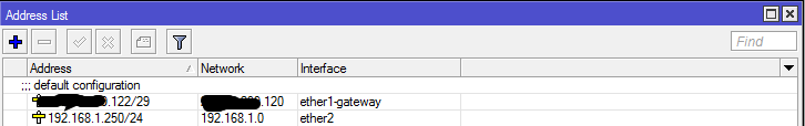

add bridge=“Main Bridge” interface=ether2
and
add address=192.168.1.250/24 interface=ether2 network=192.168.1.0
----->>> set ip on bridge not on ether2
In Winbox > New Terminal, paste this: :put [:resolve “google.com”] Does it resolve correctly? (or resolve to your ether1 IP?)
I’m guessing it resolves correctly.
You’re using a bridge but IP is assigned to ether2 instead of the bridge. Although I doubt this is the issue since most other traffic works.
You also have a script referring to updating a hairpin firewall rule. But I don’t see that rule in your config. Do you have one? Your ping to google is getting stuck at ether1. Something (maybe a hairpin rule) is causing the Mikrotik to decide to re-route the ping back to itself where it repeats this until the TTL value is depleted.

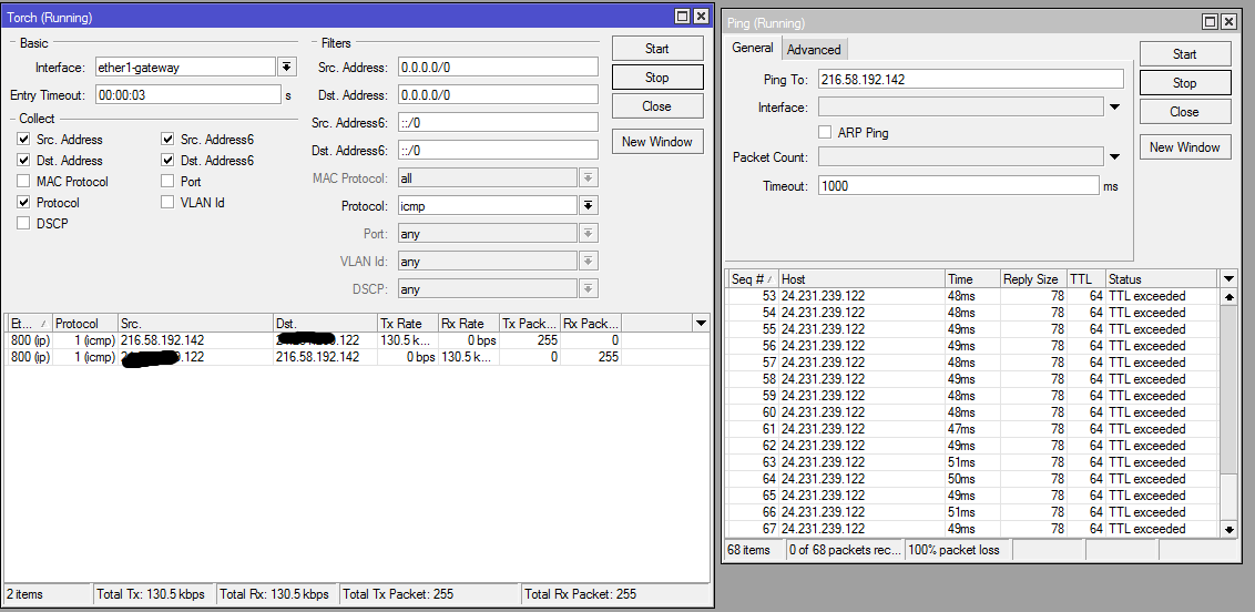

If you do a packet capture or torch in Mikrotik, check that the icmp ping packet has the correct IP (which I’m better it does) but also check the dst mac address it has when trying to leave ether1. Dst mac address should be that of your gateway (you can find gateway’s mac in IP > Arp).
So after digging more into it… Its not “all of google” its only if google resolves to a particular IP. If it resolves to 216.58.192.142, that is when its looped back. If it resolves to something else i.e 216.58.216.238, it works fine and I can ping google.com
So something about 216.58.192.142 it doesn’t like.
This is all I see when I try to do a torch:
Sorry for wasting your time… Modem just needed rebooted face palm
