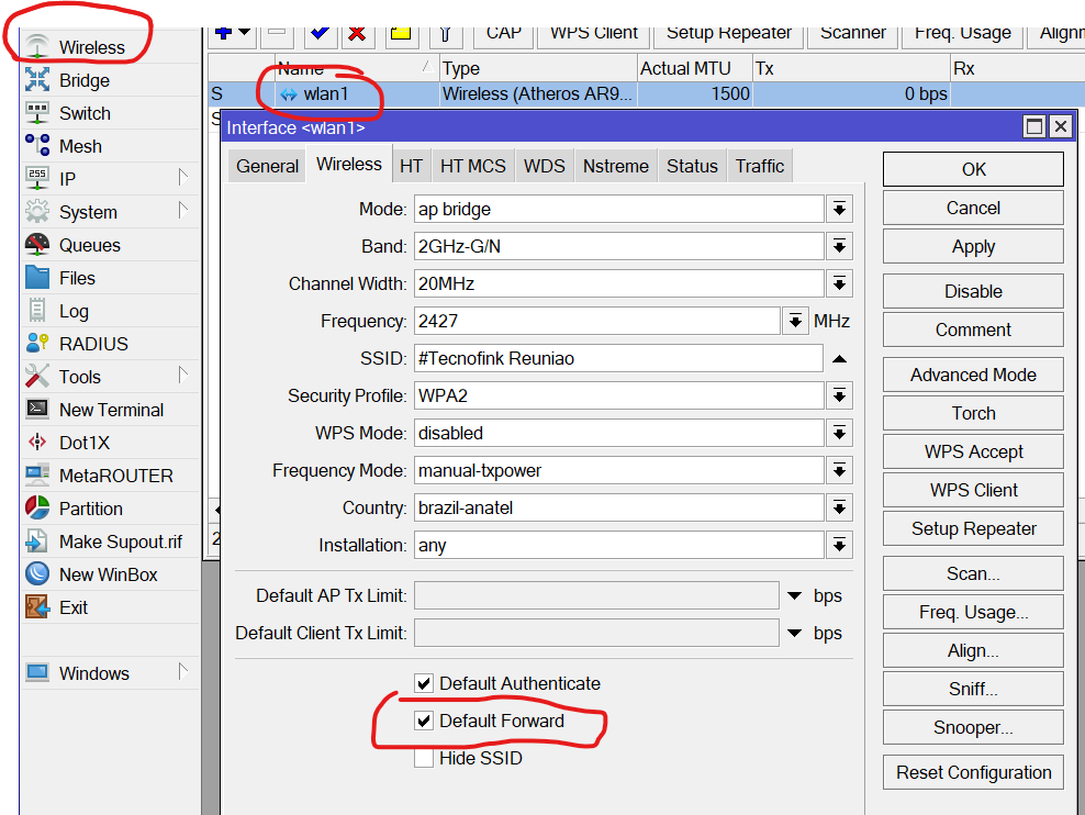

Check the setting of default-forwarding property of wireless interface. It has to be enabled (i.e. set to yes) for wireless stations to be able to talk to each other. Default setting is enabled, but somebody might have changed it to disabled (it’s a good setting for guest wireless network as it isolates wireless stations from each other).
With the command below in the router terminal you will activate default-forward on interface 0 (zero).
Default Forward is to allow communication between all devices that are connected to the router’s WiFi. If you do not intend to release it to everyone, in this case you will have to use an access list to release more specific devices.
interface wireless set default-forwarding=yes numbers=0

Update: I searched in the Microtik Haplite software and found the setting to allow all default forwarding. It took a while, because on this router the settings are found in a different place.
After enabling and saving I can see the printer on my phone and it prints just fine. Problem solved! Thank you all very much for your help.
