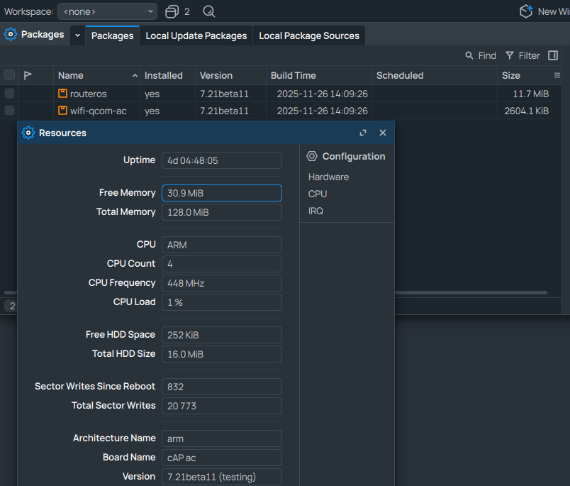

I’m using it as a repeater with capsman:
I’m not saying that 252KiB isn’t low but its working.
This is from starting out as a cap mode config and adding the Station-Bridge Interface myself.
