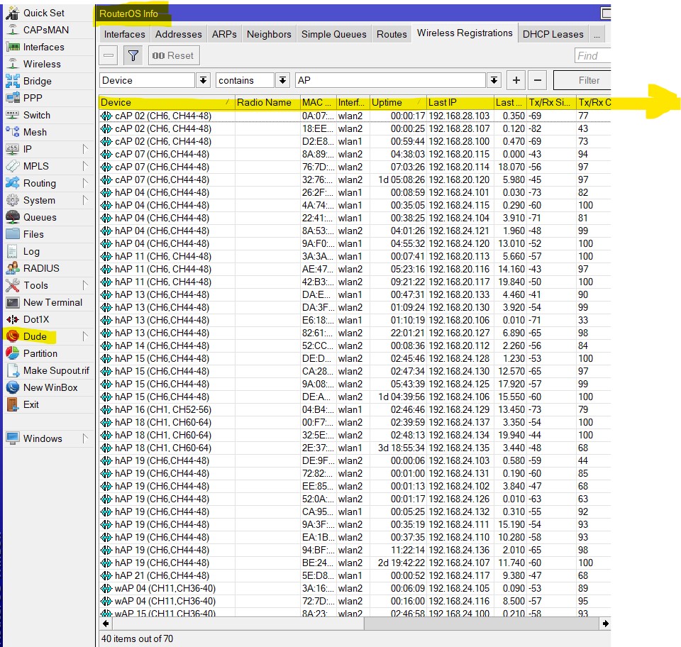

DUDE sees all connected clients also for stand-alone (non CAPsMAN) MT RouterOS AP, with more details (uptime, MAC address, wlan interface, Signal strength, Signal CCQ, interface rates, RX/TX counters, Last IP , Last seen since , Comment field, etc etc etc, just as the local Registration table.
