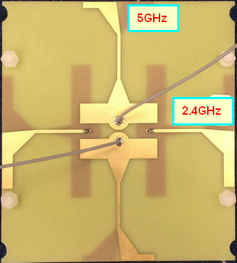

- cAP ax signal strength is generally better (as seen via Registration signal)
- Orientation of the cAP makes a difference which doesn’t align with the idea that the radiation pattern is roughly spherical
See http://forum.mikrotik.com/t/antenna-diagram-for-cap-ac-access-point/117089/1

Does Mikrotik provide radiation patterns to help better understand why orientation makes a difference?
Based on this thread the answer is no. http://forum.mikrotik.com/t/antenna-diagram-for-cap-ac-access-point/117089/1
