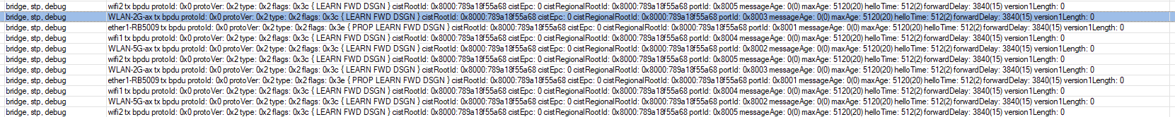

The reason I am asking is that after update from V7.19.6 to V7.20.8 I started seeing these messages in cAPax log, and I could not find any information about them:
Are these messages ok or does it mean there is some issue?

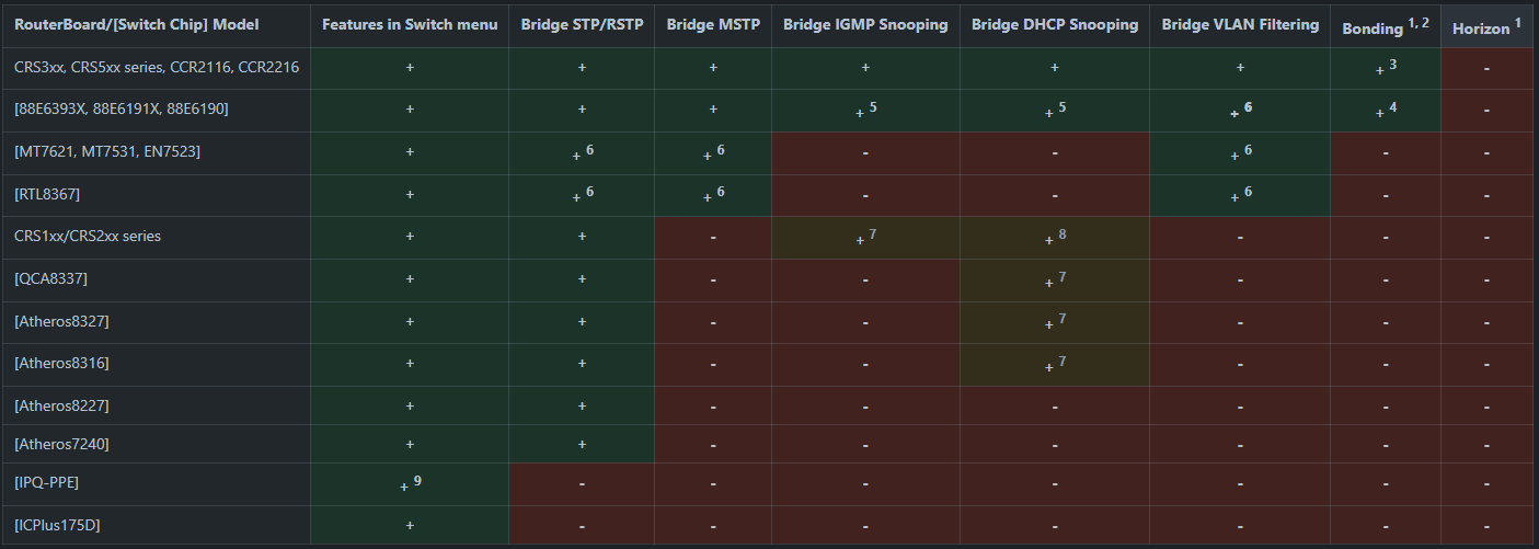

Yes, you still need that. The switch chip in the cAP ax, which is classified as IPQ-PPE, still requires turning on RSTP because none of the hardware offload features are working:
  1. Currently, HW offloaded bridge support for the IPQ-PPE switch chip is still a work in progress. We recommend using, the default, non-HW offloaded bridge (enabled RSTP).
The log messages in your screenshot have the debug topic, not info or warning or error or critical. So, normally they are not shown in the log unless you've explicitly added rule(s) for logging the bridge or stp topics.
Yes, hw offloading is still not officially supported. RSTP is generally harmless, but if you want to disable RSTP, you can do so, but then you should didable hw offload manually for every bridge->port individually.
The messages you see are simply a result of MT adding more verbose logging to RSTP. You shouldn't have to have "stp debug" enabled for your logging.
Thank you both for reply. Yes, I know those are debug messages, I have logging enabled for “bridge”, when I added “!debug” to it the messages stopped of course. But they were not appearing in the log pre-7.20 even when debug was enabled, so I was not sure if something changed about it.
