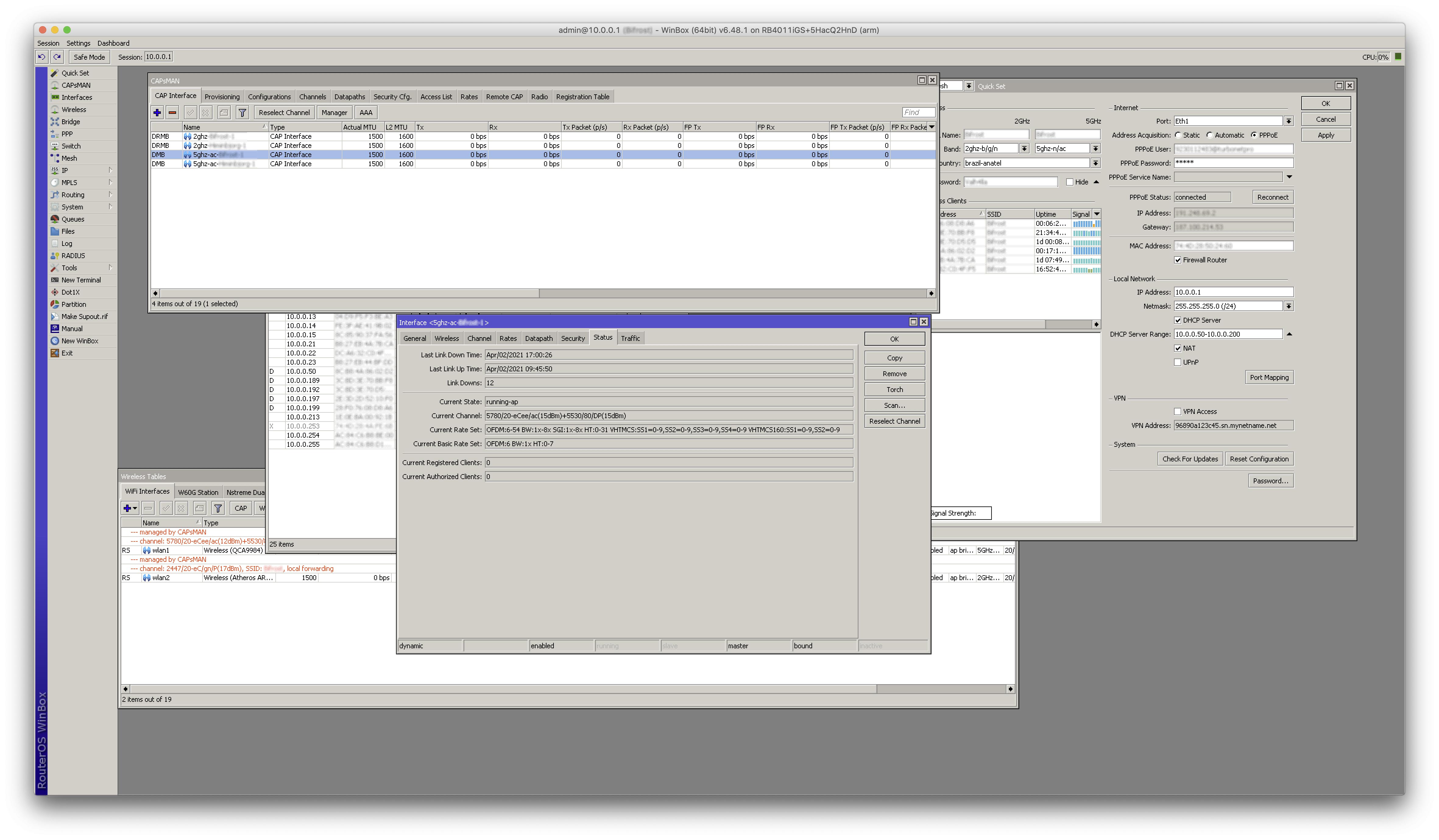

Ok, so after a lot of false positives and false negatives, I came to the conclusion that my CAPsMAN isn’t broadcasting in the 5G band.
I have two screenshots of Winbox indicating my 5G networks should be broadcasting (as I understand it), but they aren’t.

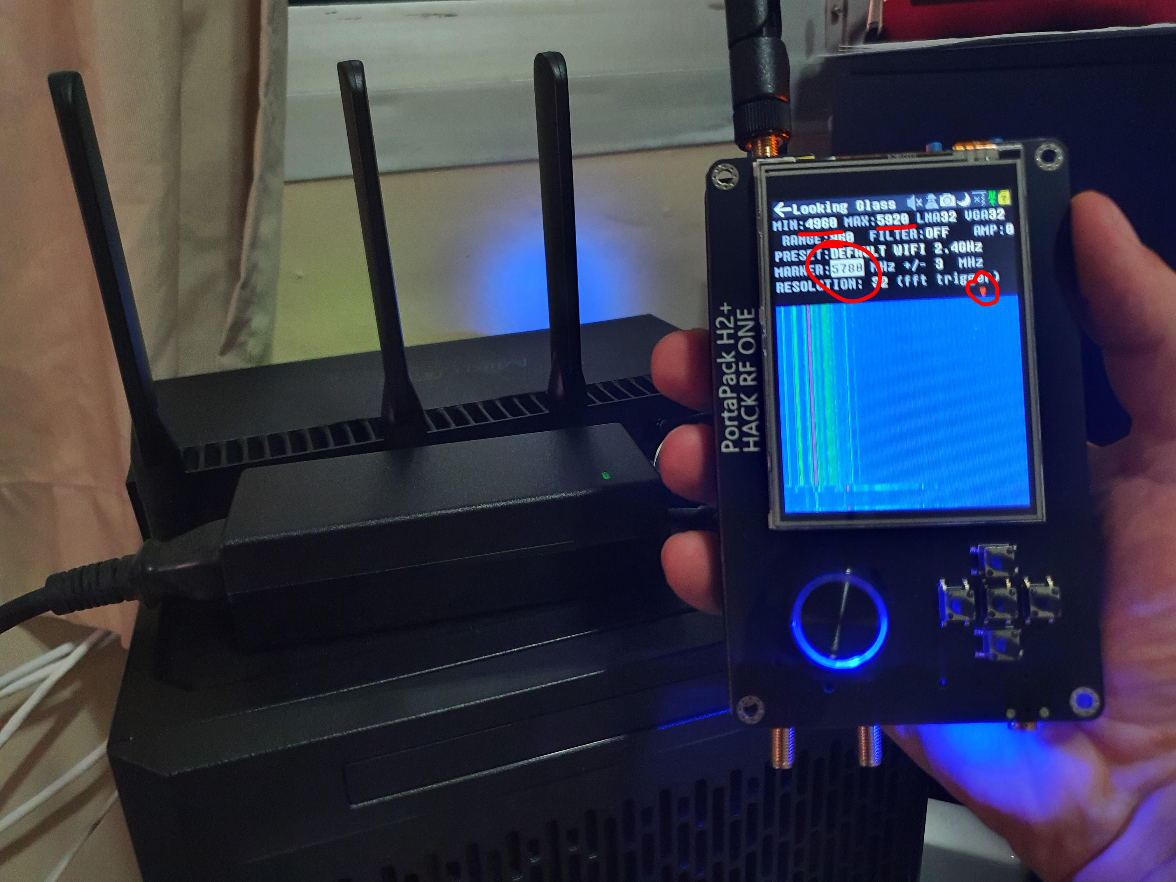

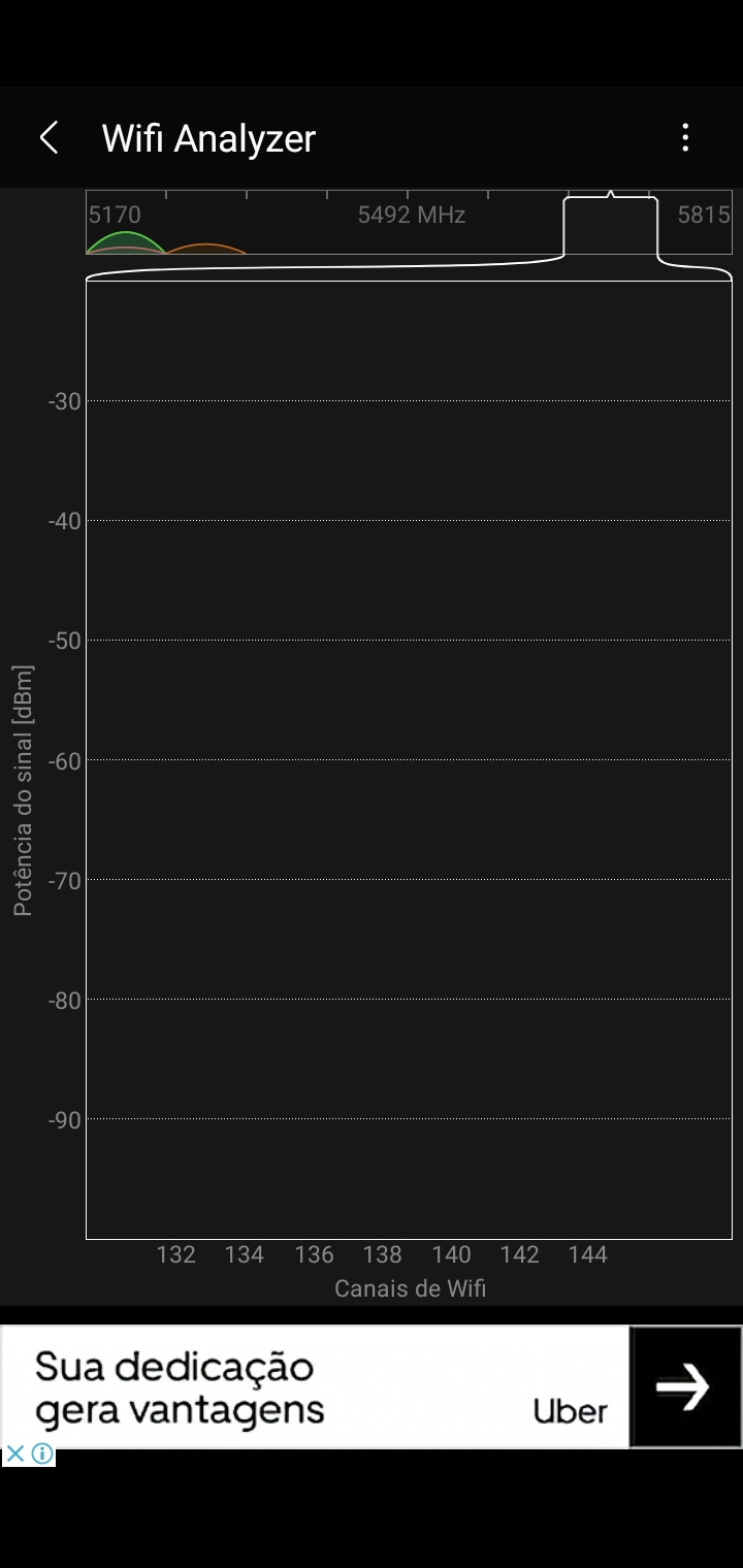

To show that they are certainly not transmitting, I have a screenshot of my Android running “Wi-Fi Analyzer” and - even better, a HackRF running a scanner - both show nothing whatsoever in the range my AP should be broadcasting.
Anyway, if “running up” doesn’t mean broadcasting, I should point out that they spend most of their time like this - and I can’t ever seem to find my SSID broadcasting in the 5GHz band.

It’s not a matter of transmitting in the wrong channel/wrong standard. The HackRF + PortaPack photo shows it’s not even transmitting AT ALL. It’s completely blue (pure noise), whereas any signal should be green. And there’s no signal at all except for my neighbours’ 5G routers in the lower part of the spectrum.

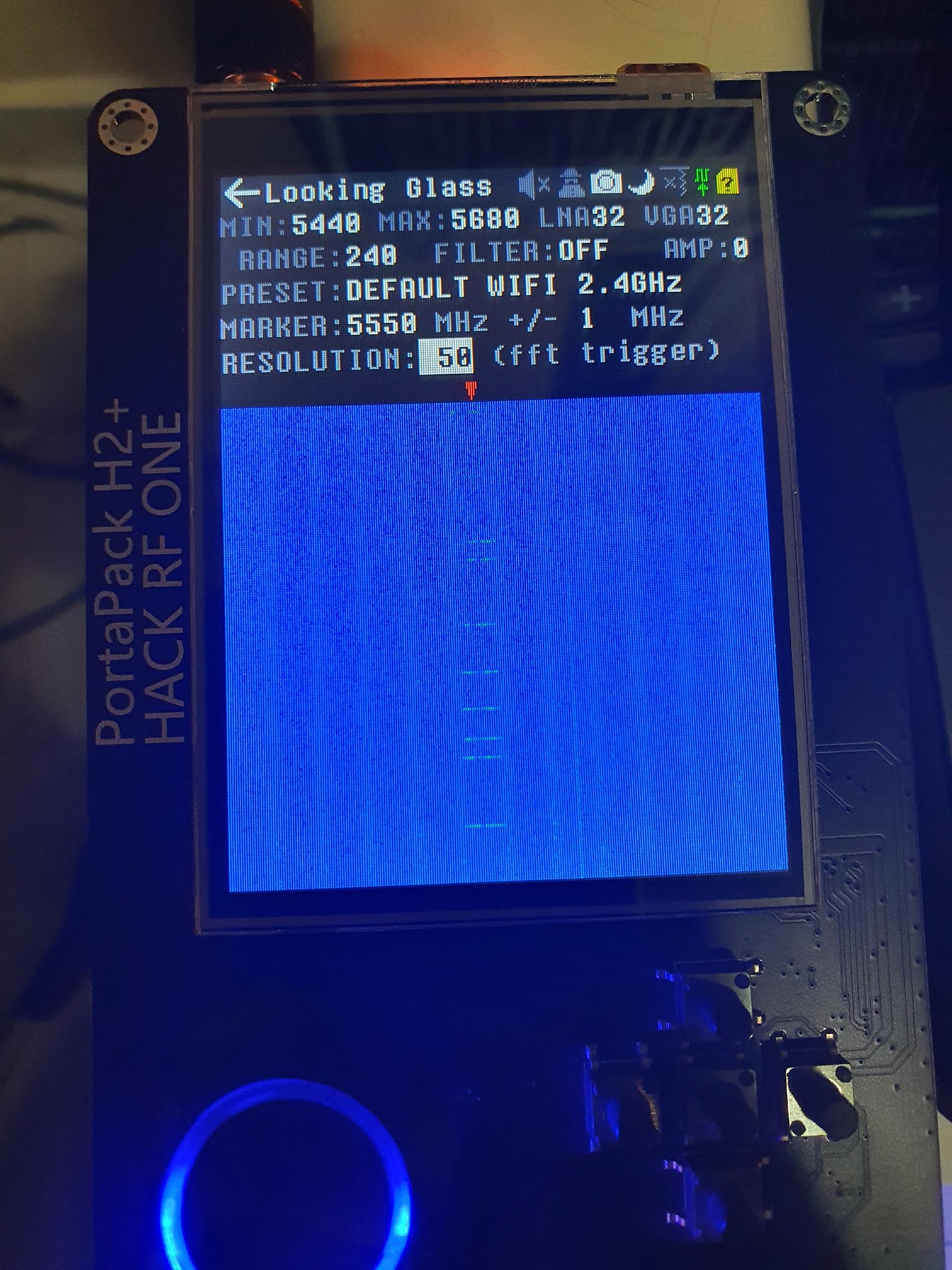

The spectrum analyzer though, detects some short blips on the primary frequency (it chose 5550/20 and 5660/80 this time) every few seconds. Very faint, very short, kinda semi-randomly spaced in time.
I suspect those are probably beacons. MikroTik has never added support for choosing the beacon interval and that makes me suspect it could potentially be random.
Please export your entire capsman config and paste here, and also show screenshots or copy and paste text of the “current channel” from the status tab of the 5GHz cap interfaces ex:
First off, you have no idea how I’m glad you’re taking the time to help. These forums, Reddit and all, are more like an exercise on self learning. But if nobody had your problem before, you’re screwed.
CAPsMAN status is:
On main router: 5550/20-Ceee/Ac/DP(15dBm)+5660/80/DP(15dBm)
CAP: 5550/20-Ceee/ac/DP(15dBm)+5660/80/DP(15dBm)

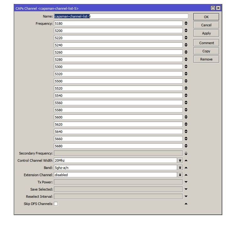

The secondary-frequency can cause problems for some devices and the main frequency table you have is not correct (ex. 5170 and 5190 are not valid, 5180 is).
The only use for secondary-frequency is if you need more than an 80MHz channel but I think that is not a major concern at the moment given that you are simply trying to get this working.

Edit: Yep, not running. No beacons.
