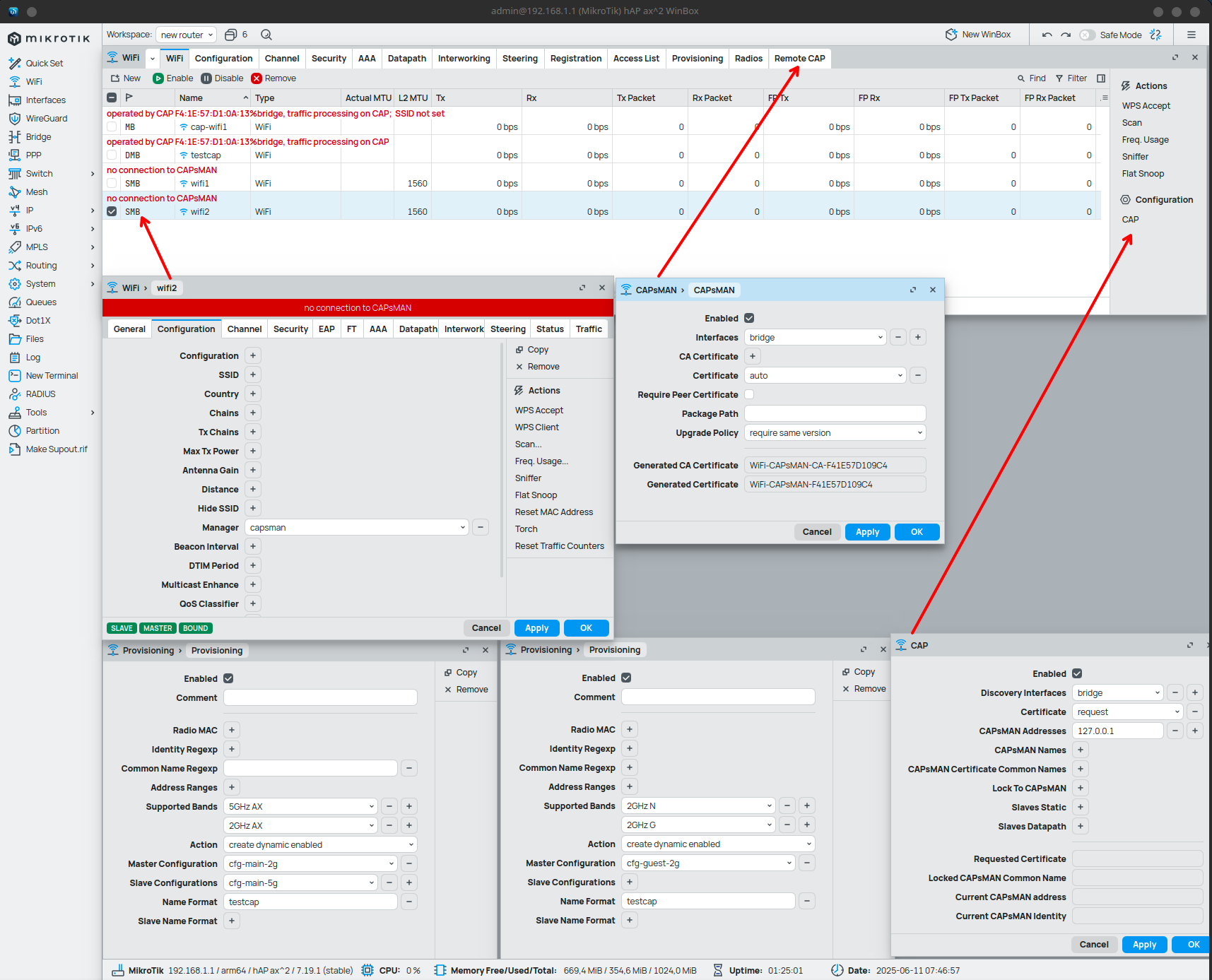

I wanted to configure my home wireless network. I have one main ax2 router which has access to the internet via PPPoE and vlan35 and I wanted to add 2 more AP ax2 routers for a fast roaming.
Wired internet access from AP to Main router works as expected.
I have 2 vlans with configured pools and working DHCP:
vlan10 which is main network where I want to have 5 and 2.4GHz band
vlan20 which is guest network, only 2.4GHz legacy bands for some smart home devices.
I’m using routeros 7.19.1, I was able to connect 1 ax2 router via CAPs to my main router and guest network works as expected.
I try to follow all kinds of tutorials available but some use /caps-man which apparently is no longer in use.
Where I fail:
  1. I’m unable to connect to local CAPsMAN from my main router and right now only the 2nd router is running.
  2. I’m unable to start main network, only guest is running and I have internet access if I connect my phone to it.
  3. Question, do I need to set manager to capsman for each wifi device (under WiFi → Configuration → manager)?

When running new wifi-qcom drivers (as opposed to old wireless drivers), CAPsMAN settings are under /interface/wifi … e.g. /interface/wifi/capsman.
If things are set “according to the book” (i.e. using proper profiles), then settings are shared between CAPsMAN (for provisioning remote CAPs) and local wifi interfaces … and thus allow for proper station roaming between all CAP devices as well as CAPsMAN’s radios. So you set the other two devices into CAPs mode but you keep configuring CAPsMAN’s own wifi radios “locally” (but using same configuration profiles as for CAPs).
Okay, that’s something in contrary to what I found in the internet. I though that local radios must configure themselves the same way as the remote CAPs.
I mean, this is also how I would think it would work - I create configuration, provision it, then all devices (including local) create proper interfaces according to the “blueprint” configurations.
From what I understand now, local devices must have configurations assigned manually?

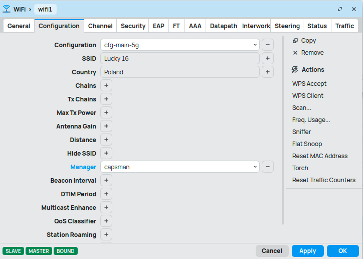

I would like to provision local radio. But for some reason my local CAP is not able to connect to local CAPsMAN. (Though AP is able to do so [???])
I even added firewall rules, I thought maybe it is blocking itself from accessing local CAPsMAN. But does not connect anyway.
And again, do I need to manually set manager=capsman for each WiFi device?
Your local radio needs to be set to local managed (local radio = radio from device you use as capsman controller).
But in the provisioning rules you can then add a line with the MAC address and the needed config.
Or set everything on the local radio using the same settings as used for capsman configs (configuration / security / …).

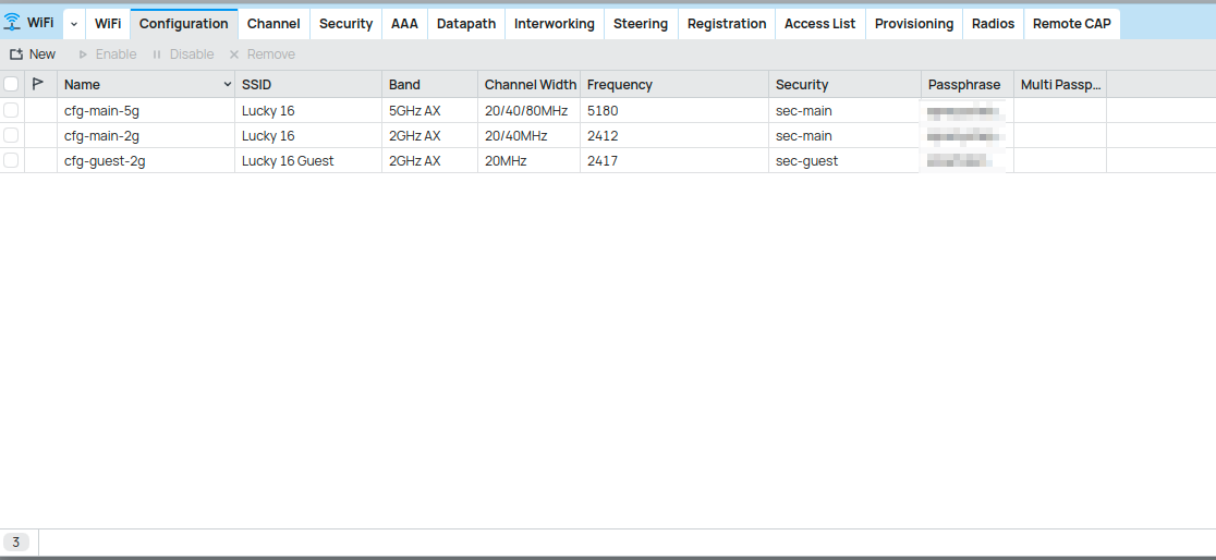

The most pleasing way for me is to configure everything in one place. I would like to create 3 configurations, 2 security rules, 2 data paths, 2 provision rules (all on my main router) and all 3 ax2 routers should automatically create WiFi network. Is that possible?
In such configuration, how many wifi devices should I have:
2 or 3?
Sure.
That’s what capsman is for.
Just be aware the 2 other AX2 devices (if you reset them to caps mode) will be in fully bridged mode on their ethernet interfaces.
Holy J… I was able to make it run together with Fast Roaming but boy was it a journey paved with pain.
#1 CAPs on main router does not work, I was able to connection to CAPsMAN but the configuration is not being applied.
My configuration on main router is 1:1 to the configuration on AP, except CAP is getting data from LAN and I needed to disable the firewall for “drop all not coming from LAN”
But it still does not work, even though I have “managed by CAPsMAN” label, wifi does not start.

#2 All AP WiFi interfaces must have manager: capsman set under configuration tab.
without it will not synchronize the settings.

#4 I revised all provisions and found out that I have 5Ghz and 2Ghz bands in one provision, this will fails since 1 interface is single band, so CAP cannot assign such configuration to a single antenna.
Now I have 1 5G provision with single cfg and 1 2G provision with master and slave.

As already indicated several times before now … radios on capsman controller itself need to be set to LOCAL managed.
Oh, and in case you haven’t already:
read and digest this Help page:
https://help.mikrotik.com/docs/spaces/ROS/pages/224559120/WiFi#WiFi-WiFiCAPsMAN
Further on you will also see what needs to be done if you want to use VLAN.
Ah… I see, another button on another tab for managing the same feature :smiley:.
So yeah, it works for local CAP as well. Thank you!
