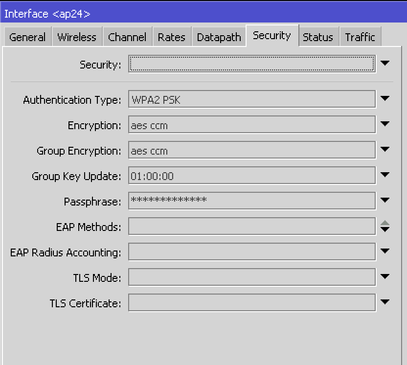

I’ve also observed this with a CAPsMAN security config – with the group key update set to one hour, it seems to occur every 40s or so (watching in Wireshark). If I unset the value to restore the default, it happens every five minutes.

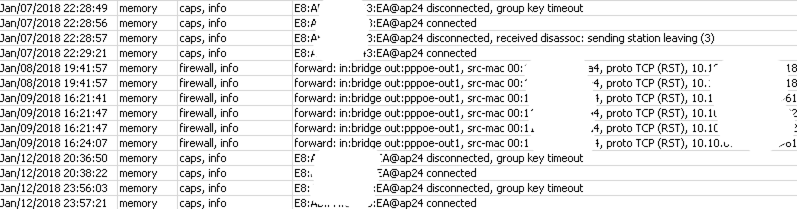

I noticed some related message in log. And the wireless and clients got disconnected during that time. Not understand why. Both Router (rb960pgs) and AP (wAP ac) are running on 6.40.5.
I expect the AP to run as stable as it could. Please suggest whether this is a bug or some configuration needs tuning? Thanks.

It would definitely seem to be a bug with CAPsMAN and group key update setting. After removing the group key update setting from the CAPsMAN “Security Cfg.”, I do not receive any more “group key timeout” messages. Wireless client connections are happy :slight_smile: I’m on latest Router OS 6.42.2.
