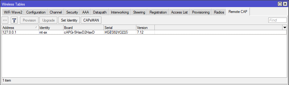

which capsman-version ? … reviewing the config-options for wave2 it seems possible to provision CAPs in groups and even per radio ?

one more thing … capsmanv2 is running on one of the cAPGi’s ? … or CHR … or ?
Rb5009
version and what it runs on shouldn’t matter.
