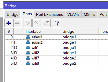

Back to OPs original question: why are ports not added to bridge? It works for local interfaces but not for caps. On CAP the bridge is always named “bridgeLocal” no matter what and wifi ports are not added (not on CAPsMAN bridge neither on the CAP local bridge).
I’m not sure if I follow you correctly, but they are added just fine… Thing is, that the bridge is always local, you can not access/see bridges on other devices. So if you create a bridge on CAP, it is accesible only from CAP itself, and vice versa. That applies for datapath too, datapath.bridge is local option and only valid for master interfaces.
Even if the docs say
Virtual (‘slave’) interfaces are by default added to the same bridge, if any, as the corresponding master interface. Master interfaces are not by default added to any bridge.
and from “by default” you can say that this behavior can be altered, but it’s not documented (or I wasn’t able to find it).
EDIT:
it’s done by slaves-datapath in /interface/wifi/cap menu.
:EDIT

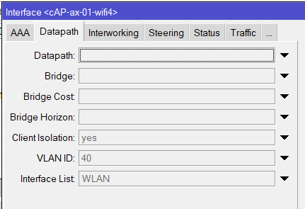

If you create a bridge on CAP, you can then set datapath.bridge on CAP’s master interface and wifi interfaces are then added to the bridge as dynamic ports. It works fine…
I can’t follow. You’re telling me: datapath has no effect in a capsman setup???
Nope, datapath has effect in CAPsMAN setup. You can use it for VLAN assignment. Just the datapath.bridge is local setting.
CAPsMAN device has no means to know what bridge/s exists on CAPs.
If you are setting CAP in CAPsMAN environment you must set 3 things on the CAP itself: manager, mode and bridge
CAP
set [ find default-name=wifi1 ] configuration.manager=capsman .mode=ap datapath.bridge=bridge1 disabled=no

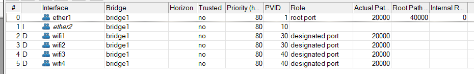

They do work :sunglasses:
Note that this is interface on CAPsMAN side… It’s same as if you want to change frequency, it’s done on CAPsMAN…
Interface was dynamically added to the list (I’m not using this, just test for you..)
