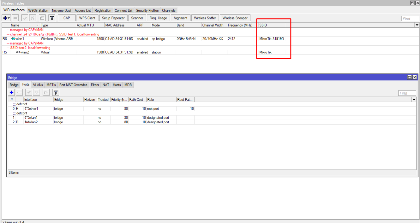

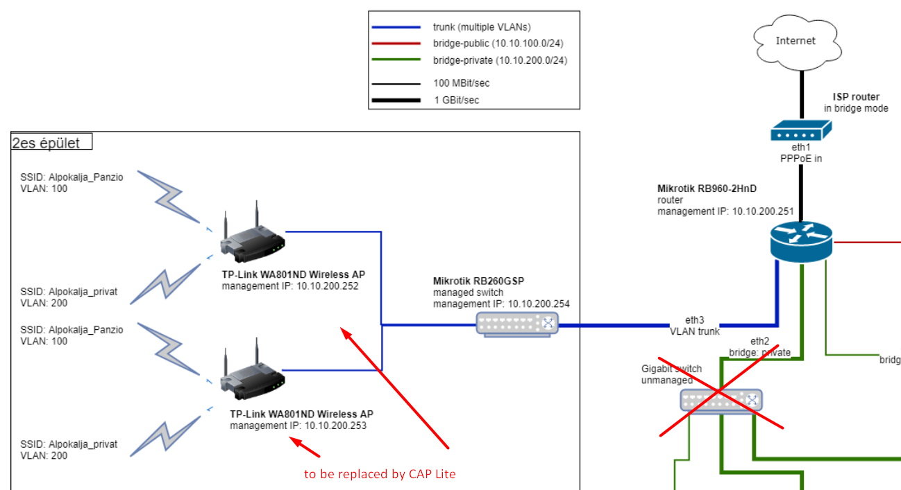

I have a RB951G-2HnD running CAPsMAN and connected to ether3 is a CAP Lite behind a switch. The CAPsMAN router is running two bridges (for private and guest network) separated by VLANs and I want the CAP Lite to broadcast two wifi networks and tag traffic according to private/public network.
CAPsMAN config:

As can be seen even in the export, the SSID does not get changed, and the network is not visible to devices. I have added firewall rules to open ports 5246 and 5247 and honestly I’m out of ideas. I have attached some screenshots and the network topology.
I hope my question wasn’t too hard to understand, it’s pretty late when I’m writing this.

Probably there are (many) more problems and errors. And network layout you shown in the attached picture doesn’t help because it refers to devices not mentioned in your text …
Turns out the SSID in the CAP’s Wireless page is not the actual SSID that gets broadcast. Managed to have it working, I’ll upload the config sometime. Thank you for your help.
