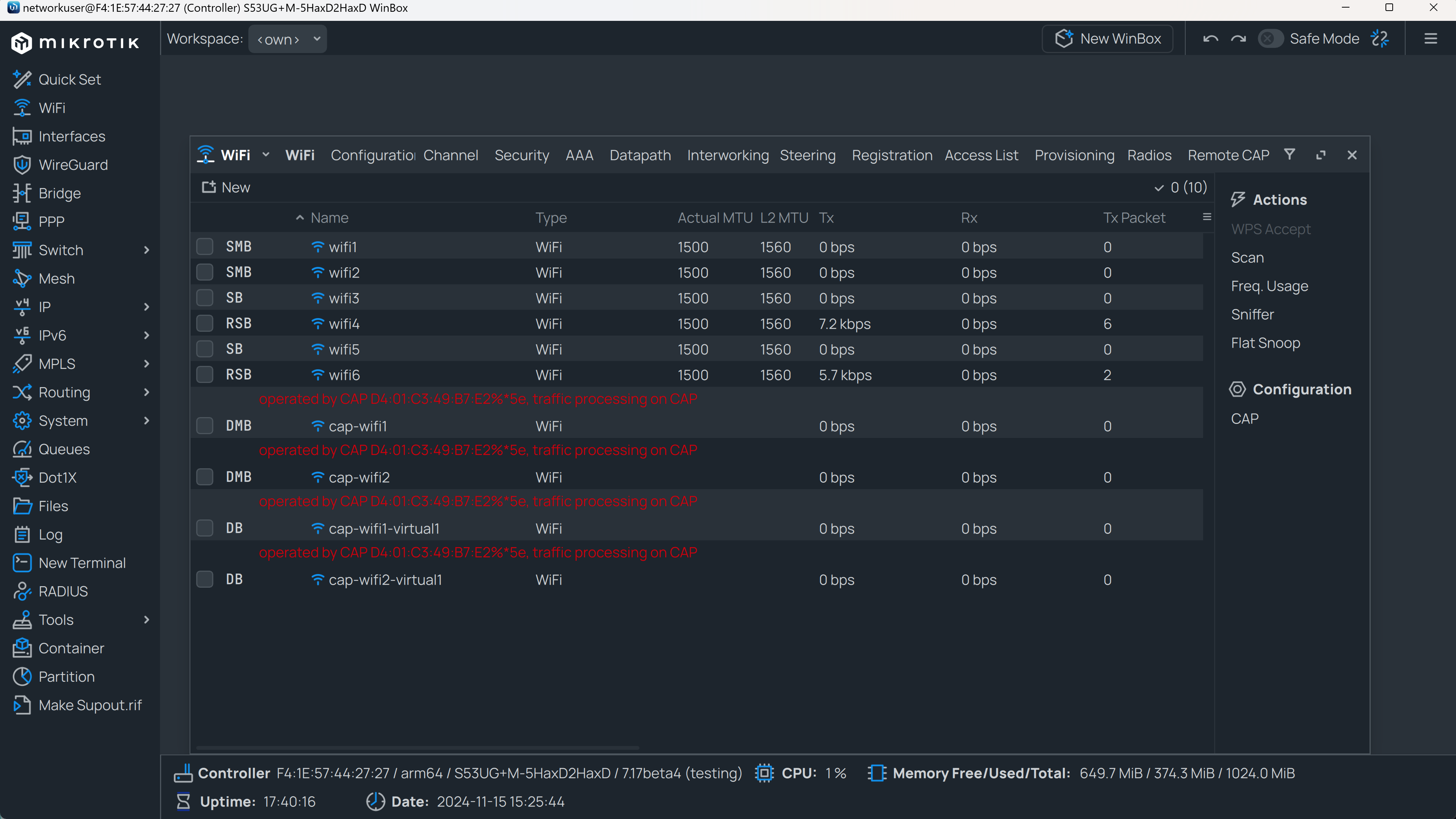

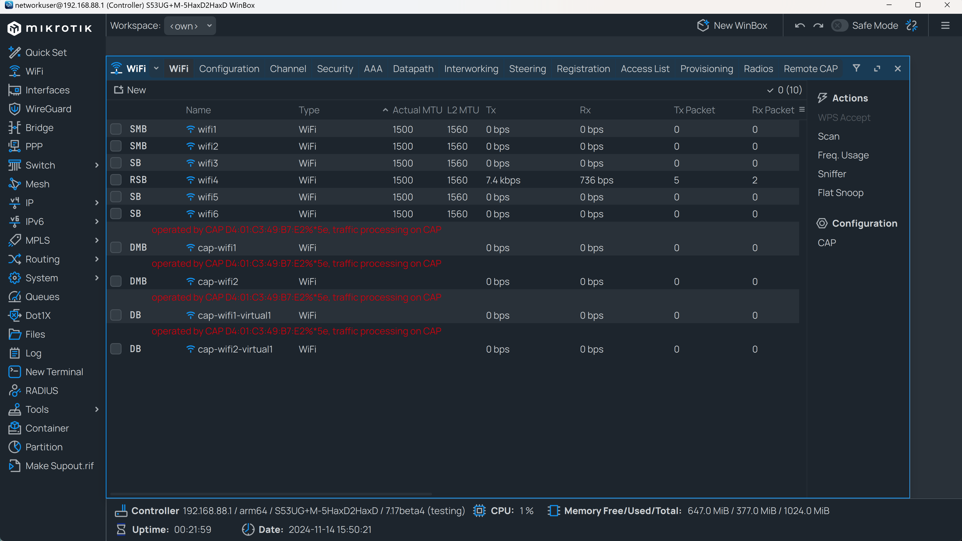

I should have adjusted the points you pointed out to me, but it still doesn’t work for VLAN 103, can you check if I have done all the steps correctly?

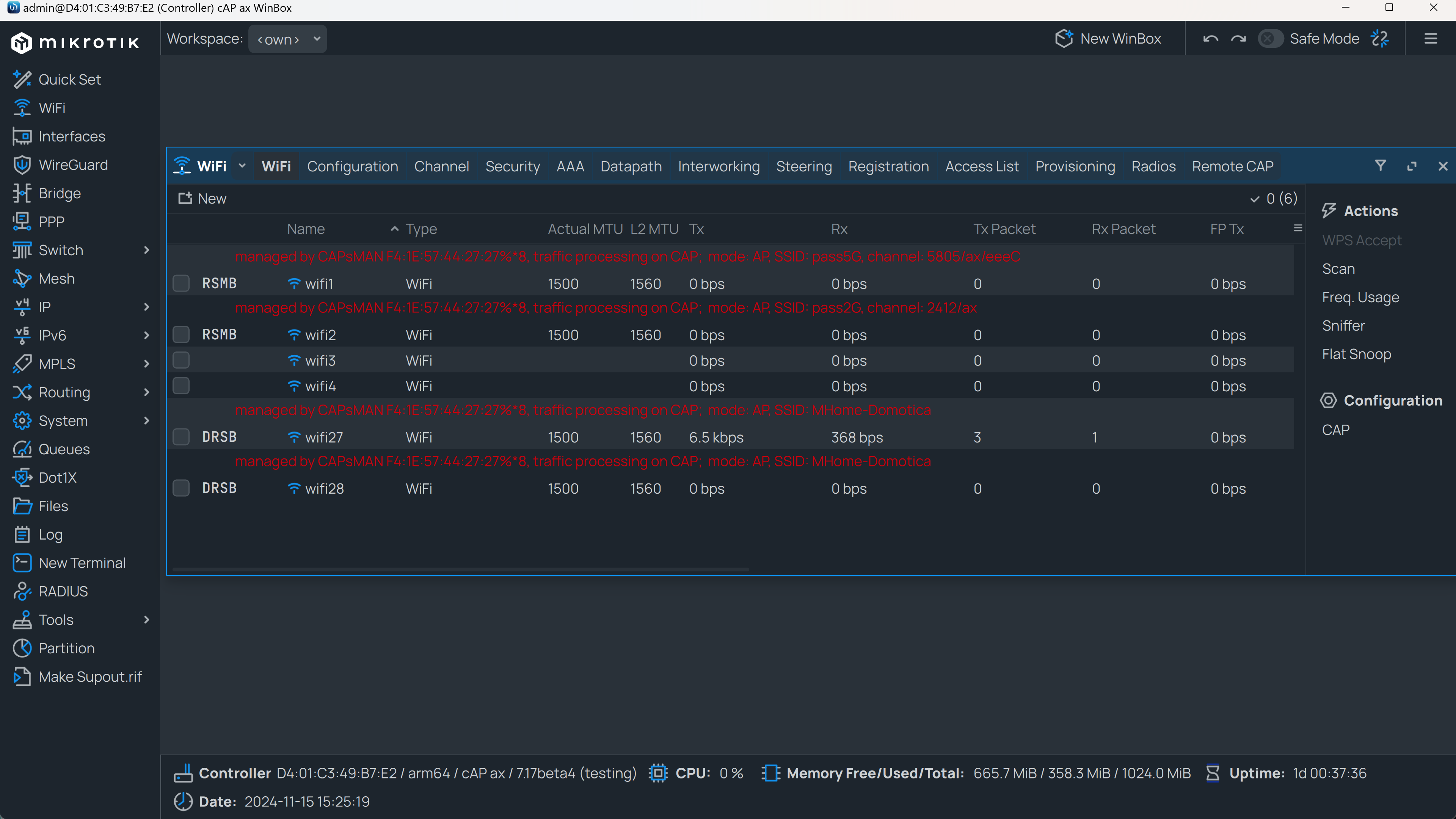

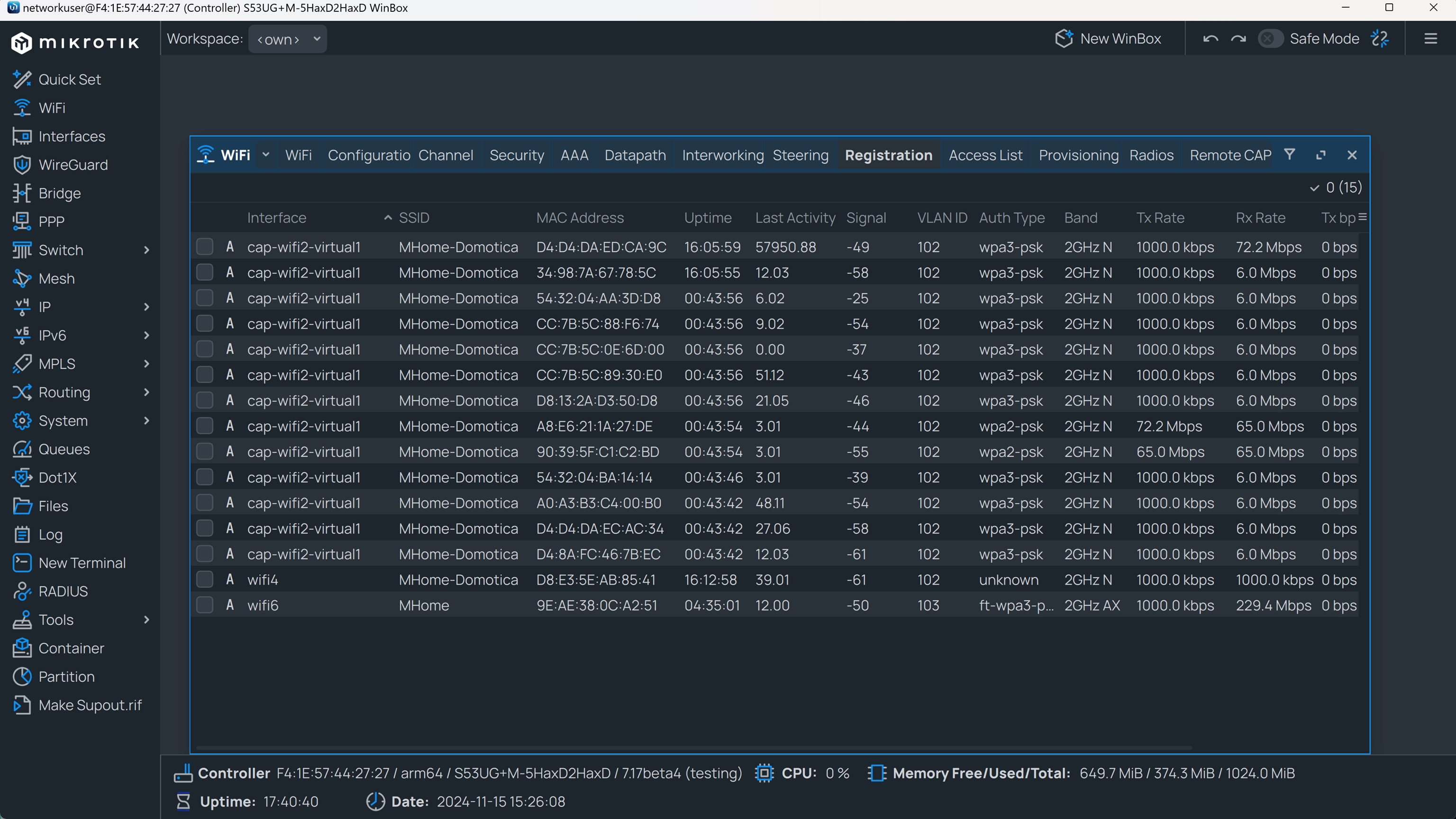

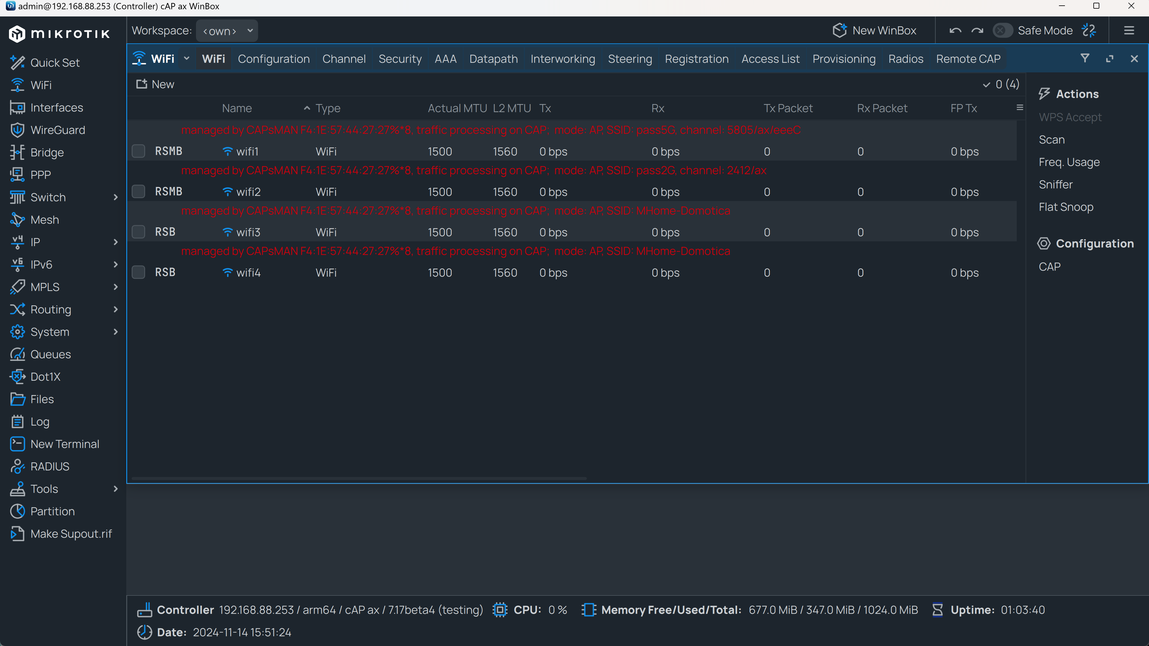

after the changes it still is not managed wifi 5 and 6 on Chatoux via CAPsman, this does not allow CAP ax to import the configuration for wifi 3 and 4 for my vlan-103, as you can see from the photo vlan-102 works properly and routes traffic via CAPax towards Chatoux (maybe it needs to be done manually?). in the meantime my wifi 3 and 4 on Chatoux has become wifi 27 and 28 on CAPax and will continue to increase with each new connection
to be clear the problem is that my MHome SSID network on vlan-103 is not found via the CAPax, only the one on Chatoux is visible.
