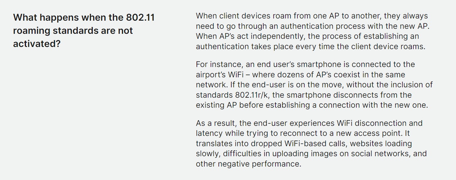

Well, CAPsMAN is required for successful roaming according to the docs - > https://help.mikrotik.com/docs/display/ROS/WifiWave2> :
For a client device to successfully roam between 2 APs, the APs need to be managed by the same instance of RouterOS. For information on how to centrally manage multiple APs, see CAPsMAN
Yes, but this “same instance of RouterOS” is only needed for Fast Roaming (FT, 802.11r) AFAIK. Because Roaming works between independent MT AP’s, but needs the authentication time before restarting the data flow. If the AP’s are on the same L2 network, the (DHCP) IP address remains valid, and is not renewed. The NATted session in the edge router towards Internet remains the same. This is an acceptable delay for many applications, but not for “Voice”.
(I expect the authentication to be done in the CAPsMAN controller the only RouterOS instance that matters here. 802.11r standard tells about pre-authenticating different instances, but not with Mikrotik ?)
source: (https://www.tanaza.com/wifi-fast-roaming/)
This makes sense. A re-connection to a different AP on the same L2 network should result in device still being available under the same MAC address in same L2 broadcast domain, just at different physical/wire/wireless location. Therefore L3 should remain unaffected, or at least things that didn’t timeout until the device got re-connected.
