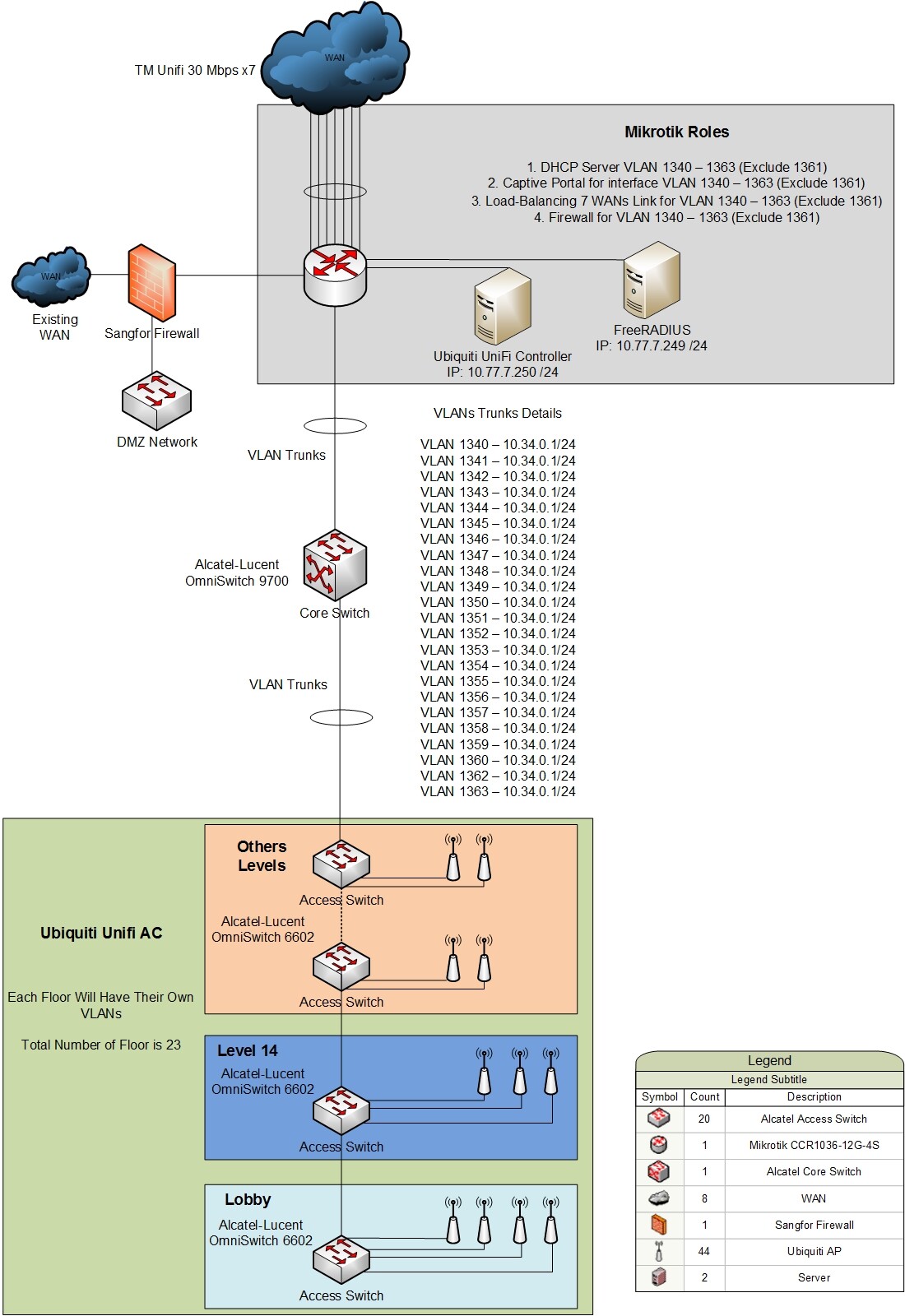

Good day everyone, let’s get to the point.
I having a problem with some issue with my current Wi-Fi Project for University.
Below is the network diagram.
If you cannot view, please download it from cloud.
http://www.mediafire.com/view/e7t6nlez762jpek/VLANs%20Hotspot.jpg
Here is what the Mikrotik CCR Do’s :-
Mikrotik Roles
  1. DHCP Server VLAN 1340 – 1363 (Exclude 1361)
  2. Captive Portal for interface VLAN 1340 – 1363 (Exclude 1361)
  3. Load-Balancing 7 WANs Link for VLAN 1340 – 1363 (Exclude 1361) - Wi-Fi users only
  4. Firewall for VLAN 1340 – 1363 (Exclude 1361)
  5. Static DNS for local traffic redirection.
  6. Layer-7 Filtering, drop BitTorrents
Ubiquiti UniFi UAP-AC setting :-
  1. Open Wi-Fi (No encryption or what so ever)
  2. DHCP mode (AP get IP from Mikrotik)
  3. Excluded in Hotspot setup (IP Binding Exception by APs MAC Addresses
Issues :-
  1. Current issue is that some users cannot make a connection to the APs, but some others can.
  2. Even when connected, they were disconnected after associated with the APs.
  3. http page redirects not working properly
  4. After I disabled the hotspot for each VLANs, all users were able to associated with the APs. And browse internet normally.
    Others setup :-
  5. FreeRADIUS as a external RADIUS DB (see diagram)
  6. UniFi Controller for controlling APs.
    Below is the Export Codes :-

add action=mark-connection chain=prerouting dst-address-type=!local \
    in-interface=vlan1340 new-connection-mark=WAN6_conn \
    per-connection-classifier=both-addresses-and-ports:7/5
    in-interface=vlan1340 new-connection-mark=WAN7_conn \
    per-connection-classifier=both-addresses-and-ports:7/6
add action=mark-routing chain=prerouting connection-mark=WAN1_conn \
    in-interface=vlan1340 new-routing-mark=to_WAN1
add action=mark-routing chain=prerouting connection-mark=WAN2_conn \
    in-interface=vlan1340 new-routing-mark=to_WAN2
add action=mark-routing chain=prerouting connection-mark=WAN3_conn \
    in-interface=vlan1340 new-routing-mark=to_WAN3
add action=mark-routing chain=prerouting connection-mark=WAN4_conn \
    in-interface=vlan1340 new-routing-mark=to_WAN4
add action=mark-routing chain=prerouting connection-mark=WAN5_conn \
    in-interface=vlan1340 new-routing-mark=to_WAN5
add action=mark-routing chain=prerouting connection-mark=WAN6_conn \
    in-interface=vlan1340 new-routing-mark=to_WAN6
add action=mark-routing chain=prerouting connection-mark=WAN7_conn \
    in-interface=vlan1340 new-routing-mark=to_WAN7
add chain=prerouting comment="load balancing for VLAN1341" dst-address=\
    192.168.1.0/24 in-interface=vlan1341
add chain=prerouting dst-address=192.168.2.0/24 in-interface=vlan1341
add chain=prerouting dst-address=192.168.3.0/24 in-interface=vlan1341
add chain=prerouting dst-address=192.168.4.0/24 in-interface=vlan1341
add chain=prerouting dst-address=192.168.5.0/24 in-interface=vlan1341
add chain=prerouting dst-address=192.168.6.0/24 in-interface=vlan1341
add chain=prerouting dst-address=192.168.7.0/24 in-interface=vlan1341
add action=mark-connection chain=prerouting comment=\
    "auth - redirect load balance" dst-address-type=!local in-interface=\
    vlan1341 new-connection-mark=WAN1_conn per-connection-classifier=\
    both-addresses-and-ports:7/0
    in-interface=vlan1341 new-connection-mark=WAN2_conn \
    per-connection-classifier=both-addresses-and-ports:7/1
    in-interface=vlan1341 new-connection-mark=WAN3_conn \
    per-connection-classifier=both-addresses-and-ports:7/2
    in-interface=vlan1341 new-connection-mark=WAN4_conn \
    per-connection-classifier=both-addresses-and-ports:7/3
    in-interface=vlan1341 new-connection-mark=WAN5_conn \
    per-connection-classifier=both-addresses-and-ports:7/4
    in-interface=vlan1341 new-connection-mark=WAN6_conn \
    in-interface=vlan1341 new-connection-mark=WAN7_conn \
    in-interface=vlan1341 new-routing-mark=to_WAN1
    in-interface=vlan1341 new-routing-mark=to_WAN2
    in-interface=vlan1341 new-routing-mark=to_WAN3
    in-interface=vlan1341 new-routing-mark=to_WAN4
    in-interface=vlan1341 new-routing-mark=to_WAN5
    in-interface=vlan1341 new-routing-mark=to_WAN6
    in-interface=vlan1341 new-routing-mark=to_WAN7
add chain=prerouting comment="load balancing for VLAN1342" dst-address=\
    192.168.1.0/24 in-interface=vlan1342
add chain=prerouting dst-address=192.168.2.0/24 in-interface=vlan1342
add chain=prerouting dst-address=192.168.3.0/24 in-interface=vlan1342
add chain=prerouting dst-address=192.168.4.0/24 in-interface=vlan1342
add chain=prerouting dst-address=192.168.5.0/24 in-interface=vlan1342
add chain=prerouting dst-address=192.168.6.0/24 in-interface=vlan1342
add chain=prerouting dst-address=192.168.7.0/24 in-interface=vlan1342
    vlan1342 new-connection-mark=WAN1_conn per-connection-classifier=\
    in-interface=vlan1342 new-connection-mark=WAN2_conn \
    in-interface=vlan1342 new-connection-mark=WAN3_conn \
    in-interface=vlan1342 new-connection-mark=WAN4_conn \
    in-interface=vlan1342 new-connection-mark=WAN5_conn \
    in-interface=vlan1342 new-connection-mark=WAN6_conn \
    in-interface=vlan1342 new-connection-mark=WAN7_conn \
    in-interface=vlan1342 new-routing-mark=to_WAN1
    in-interface=vlan1342 new-routing-mark=to_WAN2
    in-interface=vlan1342 new-routing-mark=to_WAN3
    in-interface=vlan1342 new-routing-mark=to_WAN4
    in-interface=vlan1342 new-routing-mark=to_WAN5
    in-interface=vlan1342 new-routing-mark=to_WAN6
    in-interface=vlan1342 new-routing-mark=to_WAN7
add chain=prerouting comment="load balancing for VLAN1343" dst-address=\
    192.168.1.0/24 in-interface=vlan1343
add chain=prerouting dst-address=192.168.2.0/24 in-interface=vlan1343
add chain=prerouting dst-address=192.168.3.0/24 in-interface=vlan1343
add chain=prerouting dst-address=192.168.4.0/24 in-interface=vlan1343
add chain=prerouting dst-address=192.168.5.0/24 in-interface=vlan1343
add chain=prerouting dst-address=192.168.6.0/24 in-interface=vlan1343
add chain=prerouting dst-address=192.168.7.0/24 in-interface=vlan1343
    vlan1343 new-connection-mark=WAN1_conn per-connection-classifier=\
    in-interface=vlan1343 new-connection-mark=WAN2_conn \
    in-interface=vlan1343 new-connection-mark=WAN3_conn \
    in-interface=vlan1343 new-connection-mark=WAN4_conn \
    in-interface=vlan1343 new-connection-mark=WAN5_conn \
    in-interface=vlan1343 new-connection-mark=WAN6_conn \
    in-interface=vlan1343 new-connection-mark=WAN7_conn \
    in-interface=vlan1343 new-routing-mark=to_WAN1
    in-interface=vlan1343 new-routing-mark=to_WAN2
    in-interface=vlan1343 new-routing-mark=to_WAN3
    in-interface=vlan1343 new-routing-mark=to_WAN4
    in-interface=vlan1343 new-routing-mark=to_WAN5
    in-interface=vlan1343 new-routing-mark=to_WAN6
    in-interface=vlan1343 new-routing-mark=to_WAN7
add chain=prerouting comment="load balancing for VLAN1344" dst-address=\
    192.168.1.0/24 in-interface=vlan1344
add chain=prerouting dst-address=192.168.2.0/24 in-interface=vlan1344
add chain=prerouting dst-address=192.168.3.0/24 in-interface=vlan1344
add chain=prerouting dst-address=192.168.4.0/24 in-interface=vlan1344
add chain=prerouting dst-address=192.168.5.0/24 in-interface=vlan1344
add chain=prerouting dst-address=192.168.6.0/24 in-interface=vlan1344
add chain=prerouting dst-address=192.168.7.0/24 in-interface=vlan1344
    vlan1344 new-connection-mark=WAN1_conn per-connection-classifier=\
    in-interface=vlan1344 new-connection-mark=WAN2_conn \
    in-interface=vlan1344 new-connection-mark=WAN3_conn \
    in-interface=vlan1344 new-connection-mark=WAN4_conn \
    in-interface=vlan1344 new-connection-mark=WAN5_conn \
    in-interface=vlan1344 new-connection-mark=WAN6_conn \
    in-interface=vlan1344 new-connection-mark=WAN7_conn \
    in-interface=vlan1344 new-routing-mark=to_WAN1
    in-interface=vlan1344 new-routing-mark=to_WAN2
    in-interface=vlan1344 new-routing-mark=to_WAN3
    in-interface=vlan1344 new-routing-mark=to_WAN4
    in-interface=vlan1344 new-routing-mark=to_WAN5
    in-interface=vlan1344 new-routing-mark=to_WAN6
    in-interface=vlan1344 new-routing-mark=to_WAN7
add chain=prerouting comment="load balancing for VLAN1345" dst-address=\
    192.168.1.0/24 in-interface=vlan1345
add chain=prerouting dst-address=192.168.2.0/24 in-interface=vlan1345
add chain=prerouting dst-address=192.168.3.0/24 in-interface=vlan1345
add chain=prerouting dst-address=192.168.4.0/24 in-interface=vlan1345
add chain=prerouting dst-address=192.168.5.0/24 in-interface=vlan1345
add chain=prerouting dst-address=192.168.6.0/24 in-interface=vlan1345
add chain=prerouting dst-address=192.168.7.0/24 in-interface=vlan1345
    vlan1345 new-connection-mark=WAN1_conn per-connection-classifier=\
    in-interface=vlan1345 new-connection-mark=WAN2_conn \
    in-interface=vlan1345 new-connection-mark=WAN3_conn \
    in-interface=vlan1345 new-connection-mark=WAN4_conn \
    in-interface=vlan1345 new-connection-mark=WAN5_conn \
