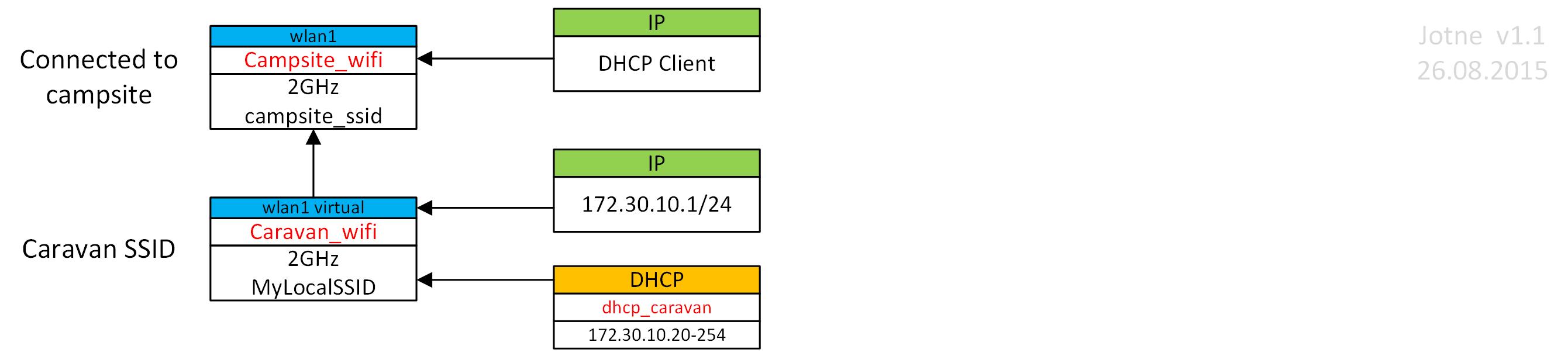

To use this, you need to set the SSID (and password if needed) to the Campsite
Basic block diagram:
Thanks. Pretty happy with the general wifi configuration.
So would you expect the campsite captive portal to pop up/pass through to the first connected client on the “LAN” side? This was my main concern.
You show the example of the Virtual wireless AP, would that suffice or would two separate cards be better?

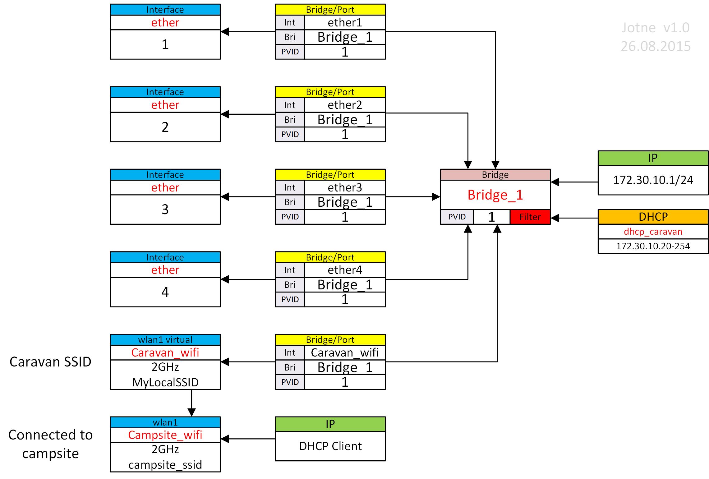

Here is an example with all interface connected to the inside net, so you can also connect cabled devices.
To make this to work we need to use bridging.

You can also setup everything in bridge modus and remove the NAT. But then you would be visible with all your devices to the campsite.
Here is layout of the bridge solution.

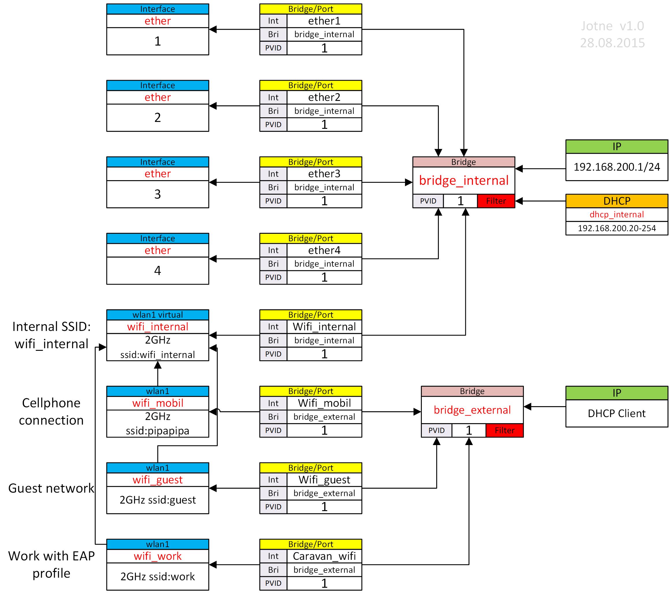

I did setup 3 different Wifi scenario, so I can select what to connect to.
Was thinking about program the push button on 951 so that I could cycle trough the profiles, but it seems that it does not react on the button when I push it. (WPS works, so button is alive)
Also thought about a script that cycle trough the profile until one connects, but my script knowlage is limited.
I do use Visio for the diagram.
Here is the config:

And the Visio:
Everything was pretty simple to setup. Connected without issue to the campsite WiFi. Captive portal didn’t just pop up but on accessing a http based webpage it redirected to the captive portal. Payed my fee and internet worked fine. Multiple devices working so far without issue.
