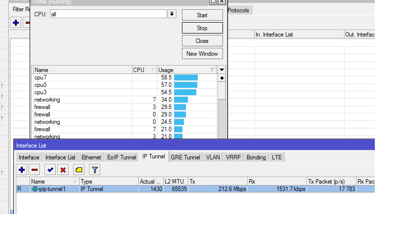

I knew that for single tunnel only 1 core will be used, what I don’t fully understand is that why my “numbers” differ so much from the datasheet for single tunnel and why my CPU won’t even max out.
If I run “just” IPIP tunnel (no IPSEC encryption on top of it) i can push using iperf3 TCP with multiple streams (e.g. iperf3 -c -P 5) I can get 500-ish Mb/s and more with multiple streams (I don’t know wether it’s “ok” or slow for the 1009 CCR) and max out cores (
Once I add IPSEC on top of it, i drops down to 200 Mb/s and adding multiple streams does nothing (multiple clients or multiple iperf3 streams doesn’t increase overall throughput just divides the max 200 Mb/s for every stream/ client, so one client gets 200 Mb/s, 2 clients get 100 Mb/s each (roughly) and so on). And core usage actually drops.
I guess with multiple IP addresses I could run multiple tunnels between sites and “load balance” to increase overall throughput?

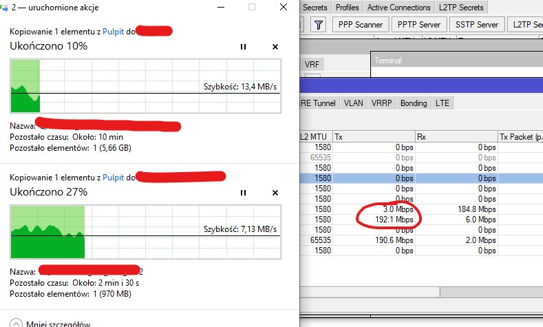

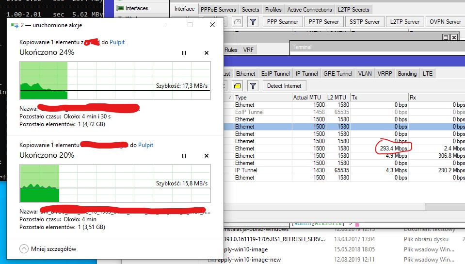

I’ve done some more testing/firewall tweaking and I’ve got some better results but also stumbled upon issue - which someone might maybe sched some light on?
  1. I managed to reach up to 350 Mb/s in “pure” IPSEC (tunnel mode, no tunneling protocols like IPIP/EOIP) in single TCP stream (both with SMB file stransfer and in iperf)
  2. I realised that there is a behaviour I don’t understand: from side A (as sender) to side B (receiver) i can get much higher throughput with parallel TCP streams (like file transfer from 2 different hosts and by using iperf3 with parallel streams 2/3/4/5). BUT from side B (sender) to side A (receiver) I’m getting ONLY max single TCP stream throughput (if max is 350, 2 streams will be roughly 160ish etc.). SO while from side A with 4 streams I’mgetting over 500 Mb/s throughput (with 550ish being absolute max with 5+ streams), from side B I’m getting a total of 350 Mb/s - more connections (streams) just decrease throughput for each stream.
    This behaviour is directly tied to IPSEC - with IPSEC disabled (all policies etc. OFF on both sides) both sides of the tunnel behave in the same way (I’m getting up to 1 Gb/s throughput with every stream increasing total throughput).
As soon as IPSEC is enabled side A gets all the benefits of multiple connections (overall throughput increase), side B is capped as “whatever is the highest for single stream)”.
I’m too much of a “newbie” (even though I have mtcna, mtcre, mtctre) to know what is the expected behaviour (is side A correct and side B is doing something wrong or the opposite) and I can’t for the life of me find the cause. I’ve sniffed packets between both tunnel ends with wireshark and both sides (side A with “higher” throughput and side B with much lower) are encrypting exactly as they should (I could see only ESP packets with “public” addresses of the tunnel ends).

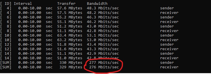

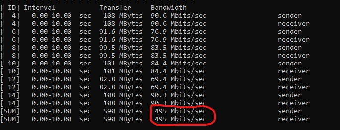

Example IPERF results:
  1. NO IPSEC SIDE A is sending:
    [ ID] Interval Transfer Bandwidth
    [ 4] 0.00-10.00 sec 248 MBytes 208 Mbits/sec sender
    [ 4] 0.00-10.00 sec 248 MBytes 208 Mbits/sec receiver
    [ 6] 0.00-10.00 sec 224 MBytes 188 Mbits/sec sender
    [ 6] 0.00-10.00 sec 224 MBytes 188 Mbits/sec receiver
    [ 8] 0.00-10.00 sec 233 MBytes 195 Mbits/sec sender
    [ 8] 0.00-10.00 sec 233 MBytes 195 Mbits/sec receiver
    [ 10] 0.00-10.00 sec 243 MBytes 204 Mbits/sec sender
    [ 10] 0.00-10.00 sec 243 MBytes 204 Mbits/sec receiver
    [SUM] 0.00-10.00 sec 948 MBytes 795 Mbits/sec sender
    [SUM] 0.00-10.00 sec 948 MBytes 795 Mbits/sec receiver
  2. side A is sending WITH IPSEC:
    [ 4] 0.00-10.00 sec 143 MBytes 120 Mbits/sec sender
    [ 4] 0.00-10.00 sec 143 MBytes 120 Mbits/sec receiver
    [ 6] 0.00-10.00 sec 155 MBytes 130 Mbits/sec sender
    [ 6] 0.00-10.00 sec 155 MBytes 130 Mbits/sec receiver
    [ 8] 0.00-10.00 sec 147 MBytes 124 Mbits/sec sender
    [ 8] 0.00-10.00 sec 147 MBytes 124 Mbits/sec receiver
    [ 10] 0.00-10.00 sec 160 MBytes 134 Mbits/sec sender
    [ 10] 0.00-10.00 sec 160 MBytes 134 Mbits/sec receiver
    [SUM] 0.00-10.00 sec 606 MBytes 508 Mbits/sec sender
    [SUM] 0.00-10.00 sec 606 MBytes 508 Mbits/sec receiver

I have similar results with SMB file transfers (side A → side B) copying from different file servers gives TOTAL higher throughput, file transfers from B to A seem to “share” single stream.
Same thing happens with IPIP/EOIP with IPSEC on/off.

It’s not just “benchmark” test but “real life scenario” with file download/upload with IPIP/IPSEC from one side 1 file caps at ~200 Mb/s, 2 files (from different file servers aswell) cap at around 150 Mb/s EACH (so 300 Mb/s total throughput)
(obrazek1.jpg)
Upload (to the same 2 file servers) caps at 200 Mb/s for 1 file, 2 files cap at 100 Mb/s, so total throughput is exactly the same as for single file. Removing IPSEC from the tunnel changes behaviour so both sides of the tunnel work the same.
(obrazek2.jpg)
With IPERF please notice difference with the PARALLESL test (test run with JUST IPSEC, no IPIP or other protocol as I found out that it doesn’t make any difference for the sake of my issue):
SIDE A - single TCP stream
SIDE B - single TCP stream
both are basically equal, CPU load on one of the cores is around 40 up to 50% (from /tools profiling)
SIDE A - 6 parallel streams:
SIDE B - 6 parallel streams:
During SIDE A as sender CPU (on one of the cores) goes up to 70-80% (which looks fine since it’s actually doing more work), while during SIDE B as sender CPU’ core never go beyond 40-50 (exactly as with single stream test).
I understand if I were using different hardware/ROS, but with exact same devices only difference in behaviour should be in config, right? I mean if I get totally different numbers just by chaning sender/receiver it has to be in the configuration? I know that “ipsec” is responsible, but what exactly forces this behaviour is beyond me.

Cores (shown in proiles and resources) seem to reflect the throughput values: when pushing more data (in paralel links) from side A - highest single core is at about 80% on both sides of the tunnel, while the other side (side B) while sending even paralel streams it maxes single core at around 50% (and receiving router also tops at 50% single core with rest being basicly idle).
If I only had access to different gear I’d test myself different scenarios wether it’s specifally CCR’s fault or VPN tunnels just work like this and in my setting one side of the tunnel is using some hidden/random tricks to work better.
