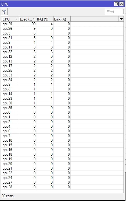

In system/resources/cpu I can see that most of the cores are 0 or 1%, but a few go higher.
Most of the time one single core CPU usage is very high, and reaches close to 100% every few seconds.
The number of this core is not the same, it moves around all the time.
Can this be the cause of my problem, i.e. one heavy task is assigned to a single core, which skyrockets its CPU and therefore slows down the execution?

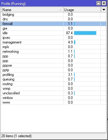

what does Tools → Profile say?
6.10 (updated my previous post)
Profile says 4% on mgmt, rest is lower.
I will post screenshot later tonight.
Here is my tools/profile:
