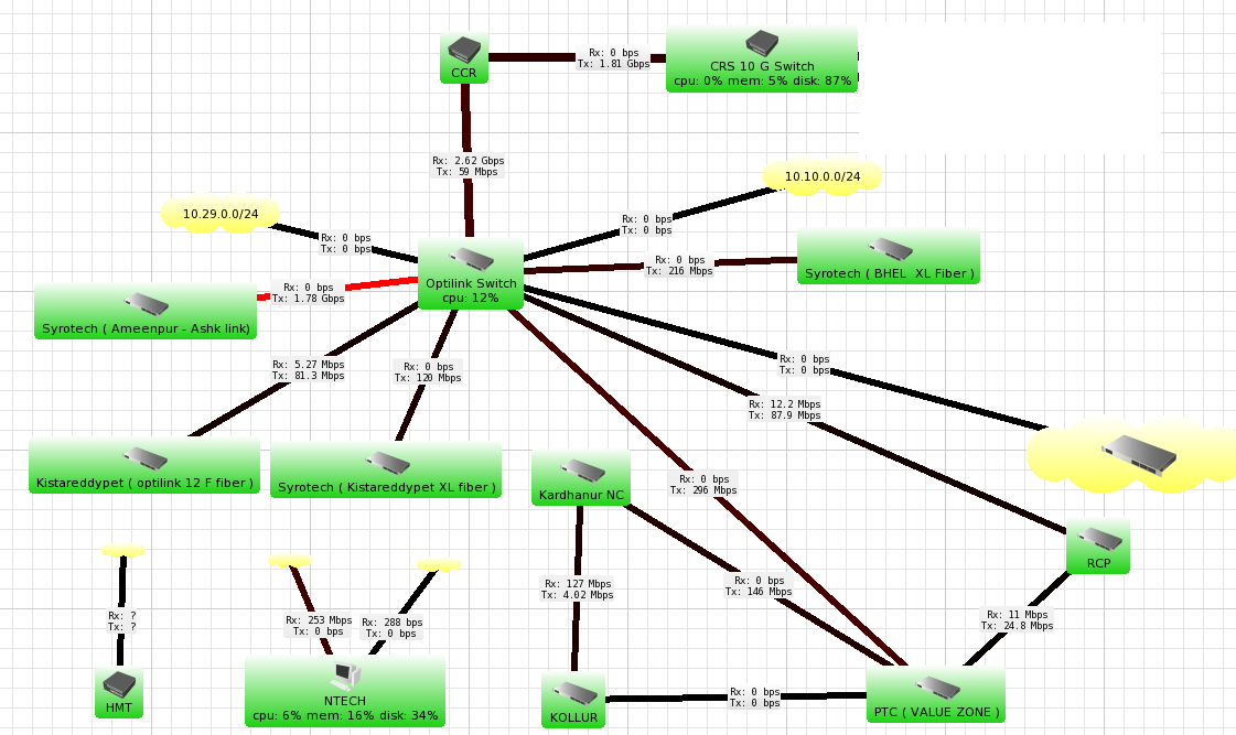

After upgrading 7.20.1 my dude server not working properly.
Traffic showing incorrect. Some running traffic ports showing no traffic.

speed on links just broken
