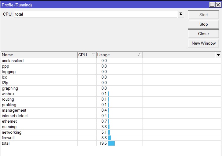

You can try to run CPU profiler (while router is under load) to see which process uses most of CPU resources.

Dear mkx,
As you see the CPU is not even 25% utilized but still the throughput is so much limited!

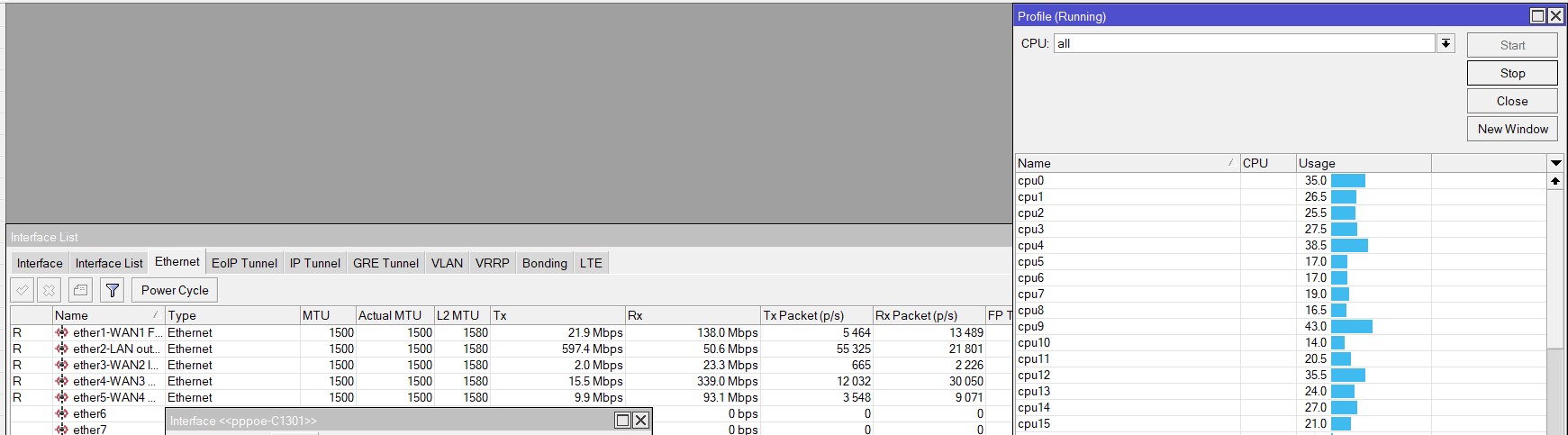

The CPU profile is inconclusive … your router has 16 CPU cores. The output you showed can mean that either all cores are utilized 20% (and should indeed be able to handle much more than they do during running profiler) or that 3 CPU cores are at 100% (and the rest are virtually idle) … or anything in between.
If it’s the later, then router is hitting the ceiling and without some drastic changes (one might be splitting duties between two devices) you will not be able to improve things.
So repeat profiling, but this time select “all” in CPU drop-down selector.

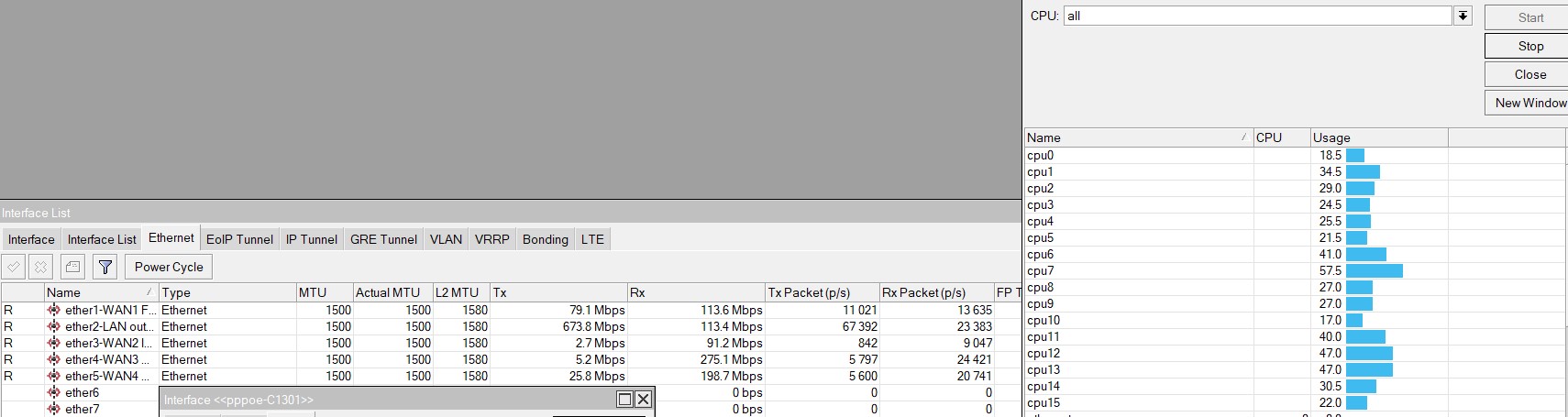

Here you go the CPU load

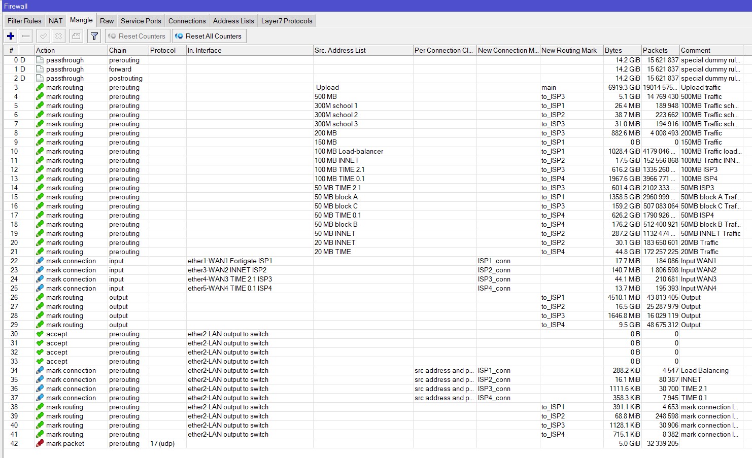

Dear chechito,
Would you like to check my firewall configuration? maybe you can find the problem for me in the load-balancing
/ip firewall mangle

i think you can try disabling fast-track, that combined with mangle does not work well
if you already disabled it please reboot to remove fast-track dummy rules
