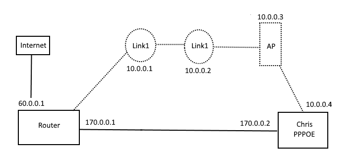

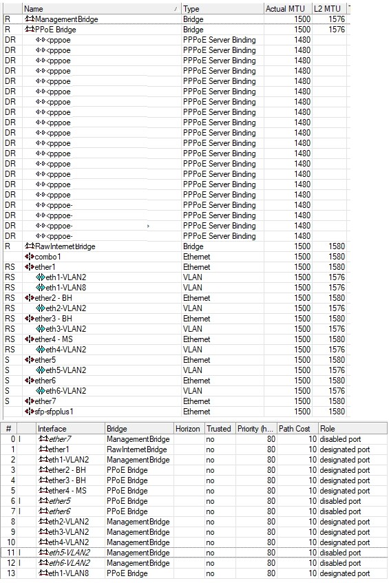

I have done a very basic diagram of the network to show the routing, please let me know what else you need, I don’t want to open the network to all and at present only the IP of my VPN can see the network remotely, I have also added the port set-up showing the VLAN’s and PPPoe sessions.

You won’t be able to use discovery tool unless you use some kind of EOIP solution. UBNT discovery requires being on the same broadcast network which you won’t be going in through VPN even though you can access the IP’s.
Setup VPN as ethernet mode and it will work. I use ehernet to discover mikrotik devices and works just fine. No doubt on ubiquity will work too

Thanks kiaunel, no problem in setting up the VPN but any pointers/guide on how best to configure Mik router would be very gratefully received … pretty sure it is getting stuck in the firewall somewhere at present.
Would really like to just get access to my local network remotely, concerned about going to Fiverr as everyone is a ‘Mik Expert’, reaching out to anyone who wants a bit of consultancy work (happy to pay) with the 2 goals 1. To gain VPN access to the local network so I can log into local radio’s and routers and 2 to help me set up a 4G failover so that I can retain access even if the fibre network fails
