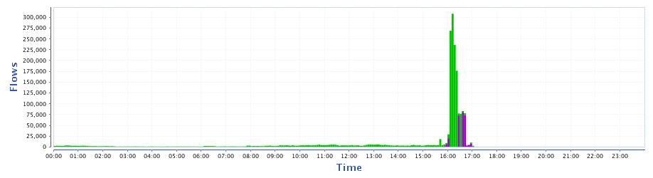

Colleagues good time.
There is a BGP router to mikrotike Cloud Core Router 1036-8G-2S + EM
To test the use 10Gigabitny port SFP +
BGP runs fine.
Decided to test the router.
From another data center generates a flood on the order of 500 megabits and packages about 300kpps
DDoS test server which is behind mikrotik.
That eventually got to download all 36 cores in the regiment and through 3-5minut router falls, tears bgp.
The router management interface is configured on another port while the management interface also
stops responding.
Here’s a picture with a 10G port
then the router dies.

Schedule download network interface:
http://pixs.ru/showimage/Skrinshot2_7415312_12912807.png
