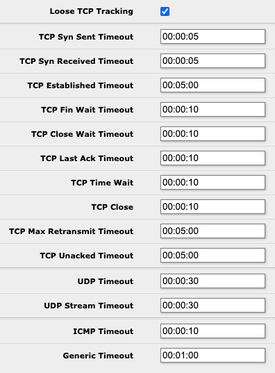

A couple of mitigating actions we have taken, that have helped reduce the duration of “flaps” and service loss from 15-20 minutes to around 2 minutes:
  1. Reduce all the connection tracking timeouts to the bare minimum, see ours:
2. Offload DNS to an external server (eg. Bind9 or Unbound), thus liberating the CCR.
3. RADIUS timeout to 1000ms, and go with RADSEC instead of UDP. We find TCP a lot more solid at times of reconnection floods.
4. Make sure your RADIUS server is tuned to cope with large peak request volumes.
Good luck!
