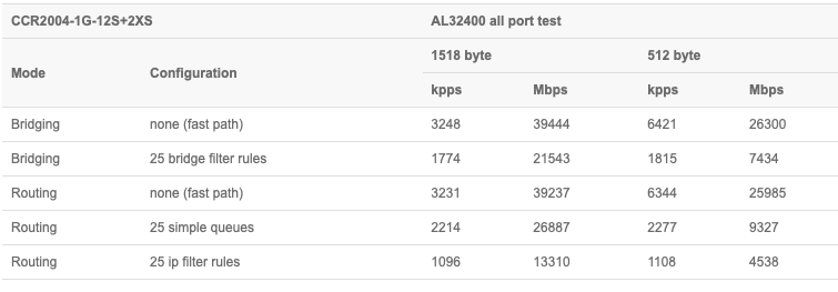

I was able to get 19Gbps because I had no filtering rules in place, which meant FastPath was turned on and virtually all processing was bypassed. The minute you put in a single firewall rule, FastPath is disabled and the available throughput through the router goes down significantly. On these quad-core processors (testing with an RB4011 as I write this), I’m seeing 40% load with 1Gbps of throughput, which explains the 2-3Gbps I was maxing out at when I had the 2004 as a border router.

My testing earlier matches the 512 byte test results with 25 IP filter rules (even with just one) on each router’s information page. I also can’t help but wonder if they’re adding in + out (aggregate) to make the numbers look better.
2004 says ~25Gbps without any rules (Fast Path), 4Gbps with 25 rules (one rule is enough to disable Fast Path). You’re right, not a whole lot better than the 1009 that you’ve got, which says 15Gbps without rules and 3.2Gbps with rules.

The 2004 12S is probably best suited for someone who needs to have a lot of SFP+ ports connected but only with bursty traffic. It has a hard time routing much over 3Gbps with firewall filters, barely hits 19Gbps with zero filters (maxes out CPU). The 2116 has a switch chip, so routing can be done in hardware, and it has 4 times the CPU.
