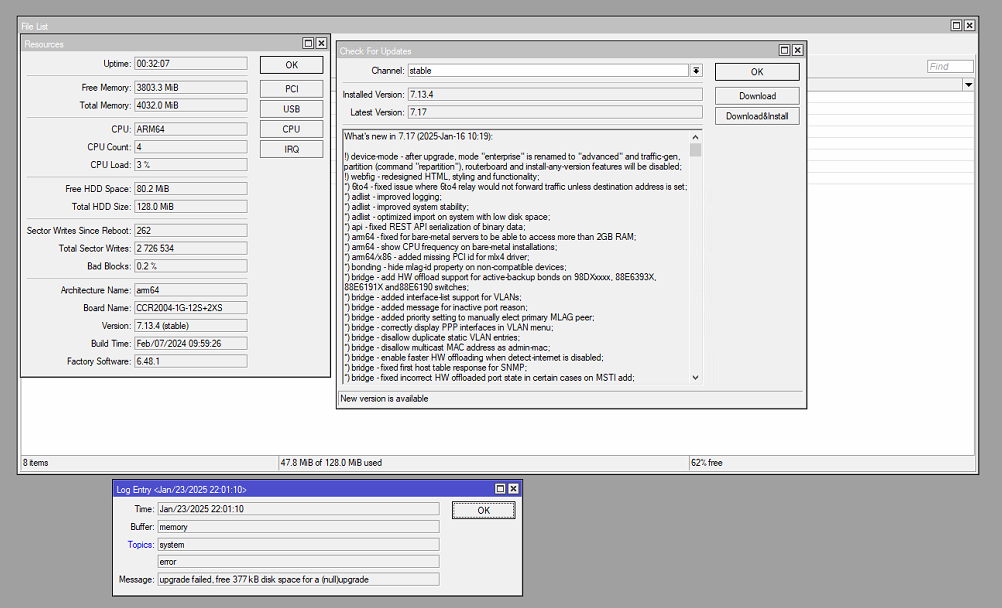

I’m having issue with updating CCR2004-1G-12S+2XS to latest ROS, getting error that I need to free disk space as You can see in the picture bellow:
What could be the issue?
Tried both methods, by hitting download & install and placing update file in Files and restarting..

Same problem when try upgrade 6.49.17 => 7.12.1 => 7.17 on CCR2004 with error
upgrade failed, free 145 kB disk space for a (null)upgrade
From 6.49.17 to 7.12.1 upgrade is OK, but from 7.12.1 to 7.17 - NO.
