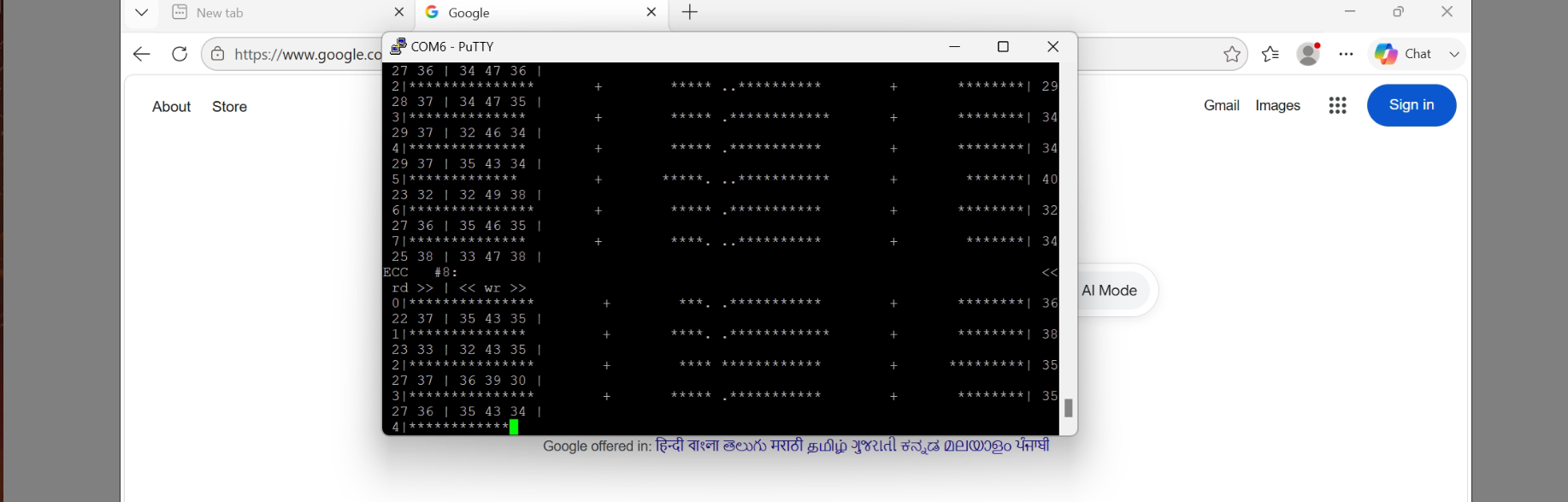

We have two MikroTik CCR2116-12G-4S+ routers that suddenly started continuously rebooting. Both routers were working normally earlier, but now they keep restarting in a reboot loop.
We connected to the routers using the serial console (PuTTY), but before we can enter the login credentials, the router reboots again.

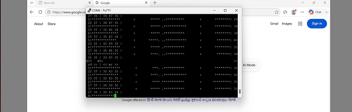

We have attached the serial console output/logs and screenshots showing the reboot process.

Netinstall - RouterOS - MikroTik Documentation - you can use the hardware reset to force it into netinstall. I would try that as a first call. Based on your screenshot, I dont think you are going to be able to recover that.

The screenshot prints a stream of non-recoverable ECC (Error-Correcting Code) memory events.

If I am reading the screenshot correctly these are hardware errors in pre-boot environment.

On a couple of my older CCR2116's, they show this stream of characters as the router's stage_2 loader is clearing RAM (memory repair). Newer models don't show the big long lines of asterisks.
What we be more interesting is to see if it gets to RouterBOOT.
