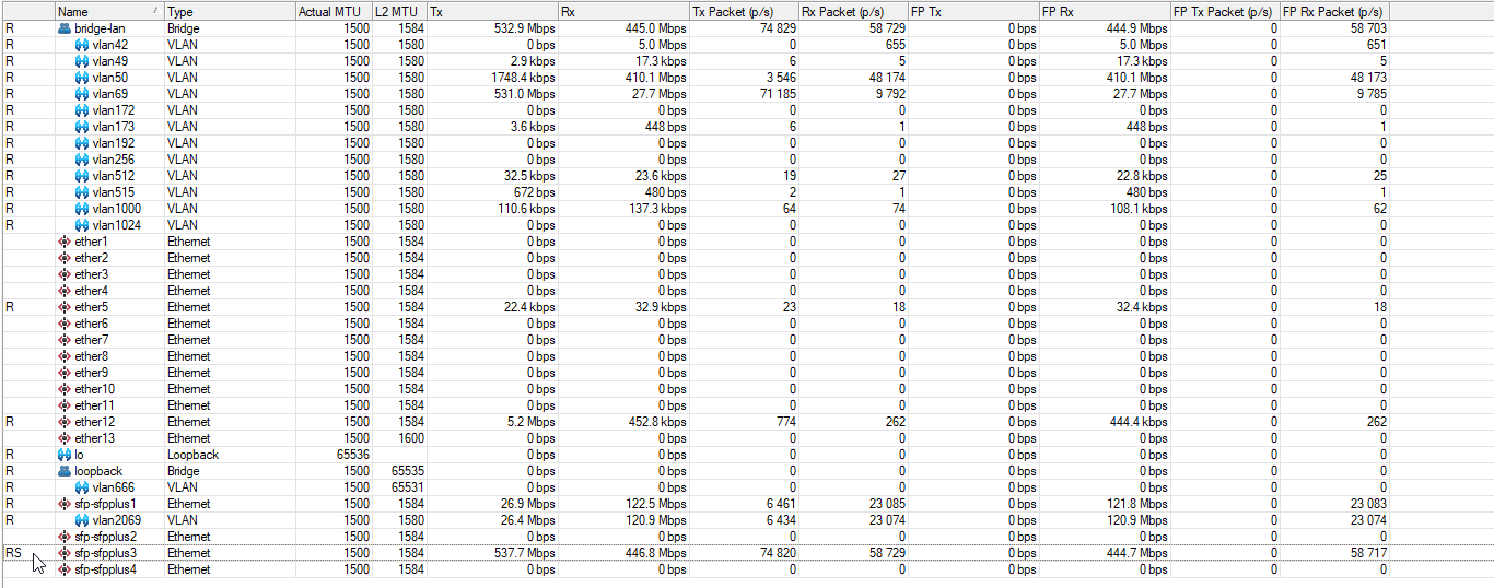

CCR2116 switch chip working but confused.. (maybe not working..)
Tx/Rx are as expected..
Is FP the ‘ip firewall’ fast path? Is this ‘hardware firewall offloading’.. and nothing to do with hardware switching?
sfpplus1 is the wan interface
sfpplus3 is the lan interface

Thank you in advance.
