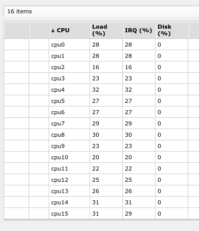

CCR2216 have terrible IO performances, very much worst than CCR10xx! Maybe they have no DMA?
We found that the new CCR2216 have very poor IO performances. The CPU is fast (e.g. BGP convergence is fast) but the input/output of packets uses a HUGE AMOUNT of CPU!
This is a screenshot of a CCR2216 used a BGP router. It has only 3 ethernet interfaces, FastTrack active, no Firewall, no Queue, nothing: for a total of 7-8Gbps of traffic it uses about 25% of CPU!!! The same task performed by a CCR1072 uses less then 1% CPU!!!
As you can see, the interesting part is that ALMOST ALL CPU power is used in IRQ!
It seems that all transfers of packets from the switch chip to the CPU is done by the CPU instead of a DMA (Direct Memory Access).
If this is true, it is a basic design flaw of the platform and we have no hope of great improvements in the future.
Otherwise, there could be some bug in the driver that handle CPU-Switch transfers, and so we can hope for same great improvement in the future.
Please Mikrotik, let us know how is the situation and if we have hope for the future…
Thanks.
you cannot compare directly the CPU Usage of CCR2216 with CCR1072, most the time in CCR1072 caculation tends to zero or a very low value
aditionally
sugestion: CCR2216 mostly is designed to be used in HW L3 Offload otherwise you will be wasting all the money you payed for it
Keep in mind: if you are focused on CPU forwarding, CCR2116 has the same CPU at a fraction of the price
I don’t understand this sentence, we use a good number of CCR1072 and similar, we know what they can do, we know the CPU load they can reach.
The point here is that FOR I/O OPERATIONS the CCR2216 use a HUGE amount of CPU in IRQ. The CCR10xx don’t, so they can give you much much higher I/O throughput.
It’s a real shame that CCR2216 WASTE almost all of the CPU power in IRQ for packets reading/writing from/to the switch.
First of all, at least until a couple of months ago (when we tried), HW L3 had a lot of bugs and was unusable in production. Moreover, there are situations where it’s not usable: full internet BGP, MPLS, queues, etc…
If CPU was not important, instead of CCR2216 we had used a CRS518 (we need the 25G and 100G (40G actually) ports).
Finally, I would like to point out that Mikrotik REMOVED the CCR10072-CCR1036 from production, they REPLACED them with the CCR2216-CRR2116, but there are situations where the the CCR1072 is still MUCH MUCH more powerful, so we remained without a REAL replacement.
Anyway, we are asking Mikrotik, not what the current situation is, but if something will change in the future.
Can we hope that in CCR2216 there will be significant improvements in the usage of the CPU for the I/O?
Thanks.
Do you also have actual impact / problem in this case, or you are just seeing 25% CPU usage and that’s all? Because from what I can tell, you are not using 75% of your CPU
Not in that case, where there is a BGP with only two 10Gbps upstreams, but could became a problem when we’ll use bigger lines.
Instead we have problems NOW with MPLS! We have a situation with about a total of 20Gbps MPLS traffic in several VPLS that we could not handle with TWO CCR2216 without start loosing packets. Mean CPU usage is around 30-40% and some single CPU at 100% (we think packet loosing is due to this)! We replaced one of them with an old CCR1072 and we have NO packet lost, and mean CPU is less than 1%!!!
Please try 7.13beta1, we made several optimizations for your case (this CPU + MPLS)

100% sure this user failed to properly configure L3 offloading, single bridge config approach with VLAN segregation. So traffic is going via control plane instead of the data plane (ASIC).

Single bridge for MPLS/VPLS with VLAN filtering and segregation using PVID. Read the link I shared and then read MikroTik official docs. Only single bridge can exist for max performance.
L3HW is supported for NAT/FastTracked etc.

giannici try latest v7.13beta2 and see if there are improvements.
The problem is NOT the single bridge, we know it. The problem is that Mikrotik has not yet implemented handling of MPLS in HW.

Exactly in what area we should see improvements?
