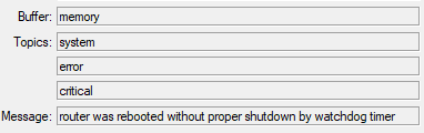

Have absolutely same behavior - random time reboot with following message :

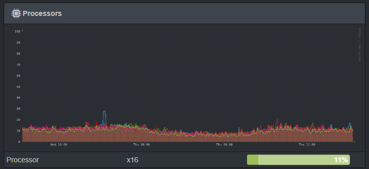

No more than 15% overall CPU usage :
